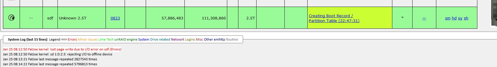

hey fellow unRaiders... so i've successfully precleared 4 drives last week but my 5th didnt make it just errored out..
it was almost done, over 50% on the 3rd cycle. i'm not savvy enough to know what the log is saying. any help will be appreciated.

and attached is whats on the unMenu screen
is it just a bad disk or is something else wrong?
thx.
I do not know.
Looks like the drive dropped off line at the very end.
should i add it to the array? or put it into another slot and try to preclear again?
You can test it for a preclear signature.
Any idea why it dropped suddenly at the end?
Timing is too coincidental. Might indicate a problem with the drive. Not sure.
i'm not sure..
one weird thing is that its identifier device ID swapped with another drive :|  one that's been running since last week and has data on it..
i'm copying some data to it right now to see if it may error out?
also unfortunately i added it to the array before i saw your msg about checking the preclear sig because unmenu "MyMain" indicated it was ready to be added. that array formatted it and in a few minutes i was added data to it..
Suggest you capture a syslog and start a new thread. Your issues may have started while doing a preclear, but it seems some funky things are happening on your server that are not due to any issue with the preclear script.
