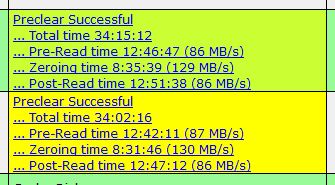

Great time saver, been using it on all the drives I have bought in the last few weeks even if they aren't being used for unraid. Works well haven't had any issues with it. A wd 3tb drive took 22:39:31 to preclear. Thanks again for this.
Attached most recent preclear of 2 HGST NAS 4T drives.
A nice gain, but not enough to really matter.    The last 4TB drive I pre-cleared was a Seagate NAS unit:

Assuming the better of your two times (34:02:16), that's only a 5% savings in time.  When you're waiting, you're waiting  :)    Nevertheless, it's a nice savings ... so I'll use your routine the next time I'm running a pre-clear.    But I suspect this modest difference is why there hasn't been a rush to use the faster pre-clear instead of Joe's tried and true version that's the de-facto standard.
Just a note, comparing a different drive on a different system doesn't make much sense. You'd be much more likely to see about a 9 hour time savings on your drive (extrapolating from the fact that the pre-read and a post-read times are approximately the same with the new version). That would be a 25% savings, which is more notable.
That said, when you're waiting, you're waiting.  :P

Yes, it was using Joe's original pre-clear (the "old" one).  That, however,  was the point --  the old" pre-clear is only 5% slower than the "fast" one.  Not enough, in my view, to use anything besides the de-factor standard that Joe maintains.
