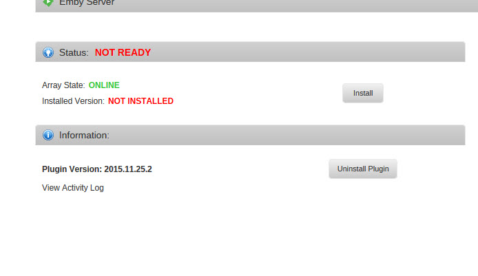

Can someone assist with the Emby Server plugin, I'm not sure why this keeps happening.  I installed the plugin for emby, and it worked for a while, but then something updated and now it says this, and I can't seem to update, it says install file not found.  I'm not sure what I am supposed to update to correct this?
Thank you for your assistance.

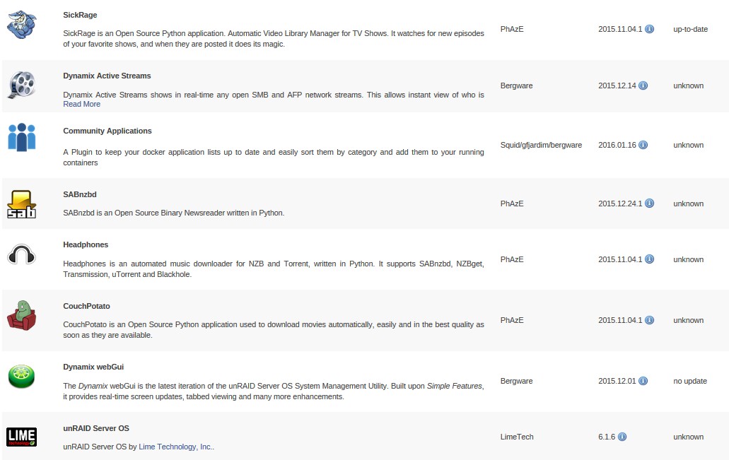

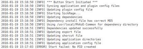

Sickrage is not starting anymore.  I was a few commits behind, tried to update and updater crashed.  Have uninstalled plugin and reinstalled plugin and I get the following log out start failed: no PID created.  How do I resolve?
How many plugins are you running? I see you don't use a cache drive, so the number of plugin apps greatly depends on the amount of ram on your server (since the OS runs from ram).
I am using 8 plugins.  They are posted below in the image. Everything has been working correctly until I updated sickrage due to being behind in commits
Sorry to bug, here is the log I get when I try to update.  I'm nor sure what I am missing here?
2016-01-19 20:57:02 [iNFO] *** Install Initiated ***
2016-01-19 20:57:02 [iNFO] Installing Emby Server...
2016-01-19 20:57:03 [iNFO] Updating dependencies
2016-01-19 20:57:03 [iNFO] Dependency install file has correct MD5
2016-01-19 20:57:03 [iNFO] Using /mnt/cache/.PhAzE-Common for dependency directory
2016-01-19 20:57:07 [iNFO] Dependencies updated successfully
2016-01-19 20:57:07 [iNFO] Updating Mono
2016-01-19 20:57:07 [iNFO] Mono install file has correct MD5
2016-01-19 20:57:07 [iNFO] Mono updated successfully
2016-01-19 20:57:07 [iNFO] Updating export file
2016-01-19 20:57:07 [iNFO] Updating shorcut file
2016-01-19 20:57:11 [WARNING] Unable to get latest version from online - Checking USB for any install file
2016-01-19 20:57:11 [ERROR] Install failed: Install file missing
