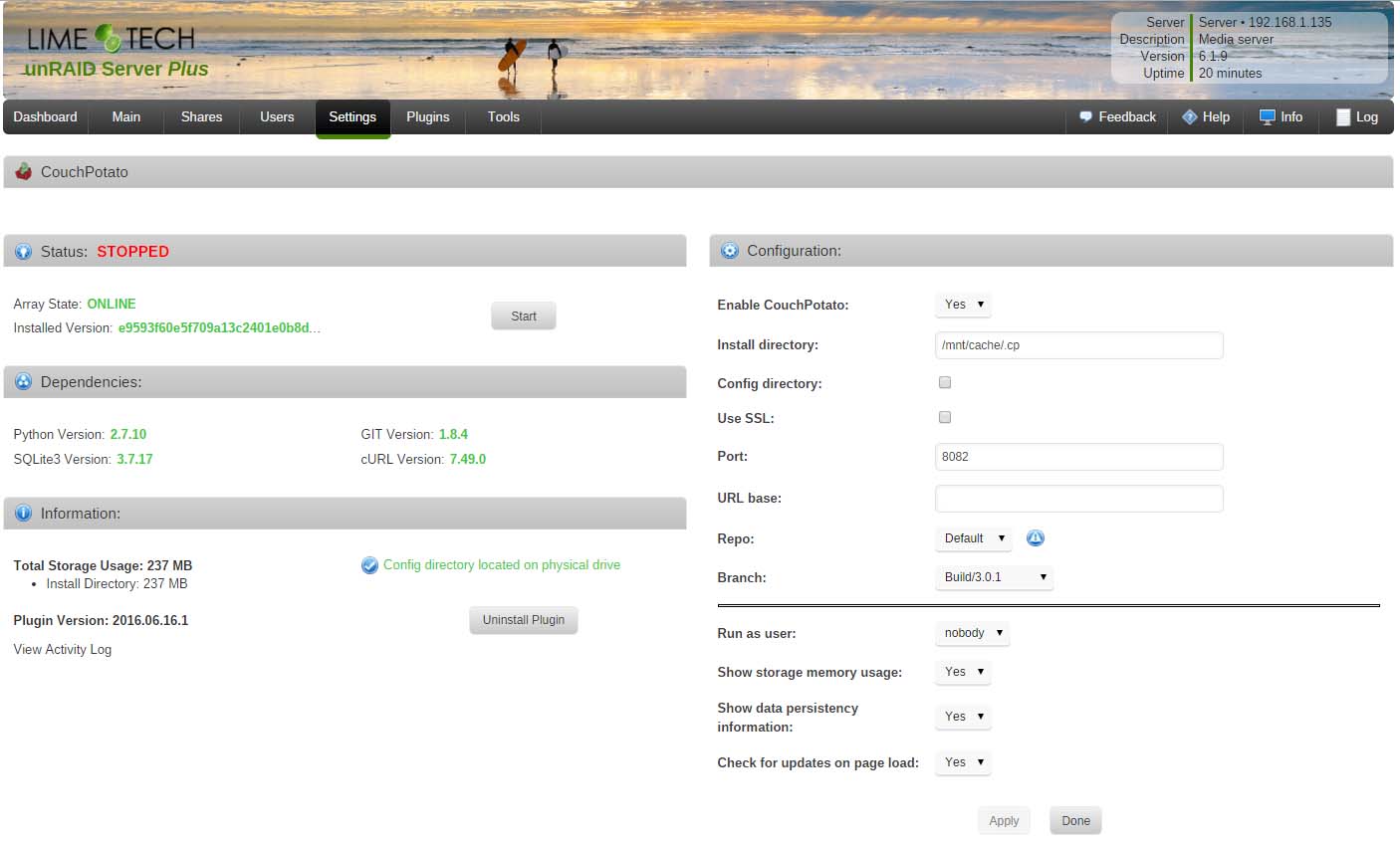

Thank you Phaze. For me it isn't SickRage (I don't use it), it is CouchPotato, SickBeard, Sab, and Transmission. None of them will start.
I am having the same problem. I ran into a problem with one of my plugins where it would not start. Got the no pid created. I ran the new permissions and still did not work. Now not only do I get No PID created but I get "Dependencies not working" on several of them in the different plugins. See attached photo. I deleted the plugins and reinstalled and same issue. Any suggestions.
For that, try deleting the PhAzE-Common folder, them reinstall the plugin or reboot the server.
It's at /mnt/cache/PhAzE-Common
After following these instructions, I now have Sab, Sick and Transmission working again, but am still getting the start failed, no PID created error for Couchpotato.
syslog.txt
First, back up the config folder, delete the original one and then see if it starts.
Alternatively, try to manually set the config folder location in the plugin settings.
PhAZe, deleting the config folder got CP up and running. What from the original config is should be moved over to restore the database and previous settings? I appreciate your help. I have been using your plugins since you started them and this is the first issue I have had.
I opted to just reenter all my data. it was easy and this way I'm not importing the problem back in. Thanks for your help

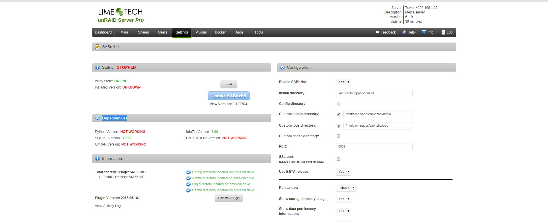

Yesterday I noticed that SABNZBD was reporting a new version available, so I checked the plugin and without thinking clicked upgrade.
It should have upgraded to version 1.1.0 (the release), I had previously been running on a release candidate for 1.1.0.  However, it downgraded to 1.0.3
I'm sure it's an update file location, or a naming issue.  Just thought I'd report it.
Thanks
Mike
FYI.. Checked SABNZBD again today, and low and behold version 1.1.0 showed up again as a viable update.  This time it downloaded and updated correctly, so all is good.
just fyi
Yea, they likely miss labeled the actual download zip file and corrected it today. Something they've actually done before. :)
