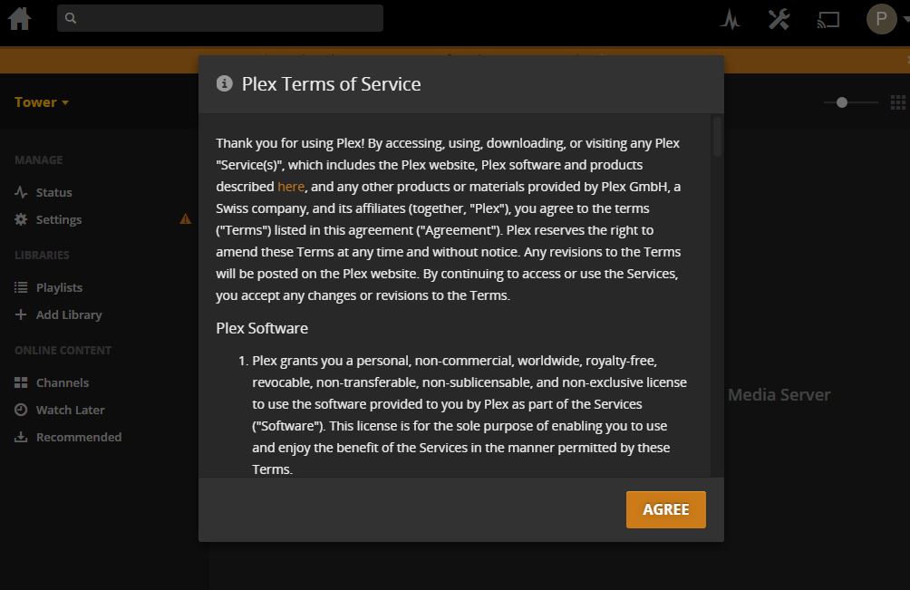

I have an issue though. Plex is my sole plugin. When I have to reboot the server, everything restarts fine, except Plex which displays the standard welcome page, not directing me to the PMS of the server. The remedy is simple, I have to go to Settings> PlexMediaServer>Stop then Start (on UnRAID GUI).
How can I fix this? Even by inserting some command line in some files....

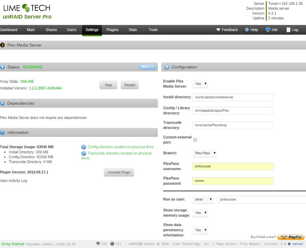

When it starts up, what url are you using to connect to when you see the welcome page? Also can you post an image of your settings page so i can check out where you're  pointing the directories to?
3 screen-shots in  attachment
Thank you a thousand for not letting me down. You can send me a PM to avoid filling your thread with my garbage.
I would recommend setting "show storage memory usage"  to 'no'  so the plugin page loads faster.
Is /mnt/appdisk a share on your cache drive or array?
When you run the app as user 'nobody',  does it have the same problem? It seems that when it initially starts it can't read the Plex configuration XML file and starts fresh. Then when you restart the plugin it corrects the permissions.

No, it is a PLEX dedicated 240 GB SSD (see HC)
Done. Then reboot. No change.

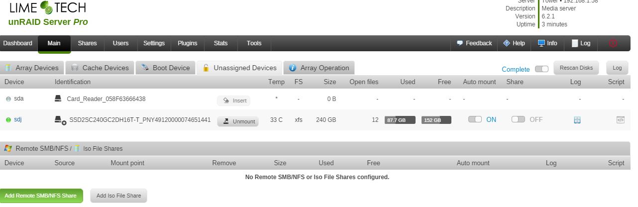

Ok so i see you're using the unassigned devices plugin to mount the drive you use for the Plex library.  Chances are that since 'P' comes before 'U' ,  my plugin is initialized / started before that drive is mounted. This is because unraid loads the plugins alphabetically. This is why restating the plex server resolves the problem too.

Also, Unassigned Devices typically mounts at /mnt/disks/whatever
Are you sure that /mnt/appdisk actually exists on any disk?
I would assume so because it works when he restarts the plugin.
/mnt/appdata can exist as long as something creates the folder. Doesn't mean it is actually on a disk. If no disk is mounted there then it exists in RAM.
