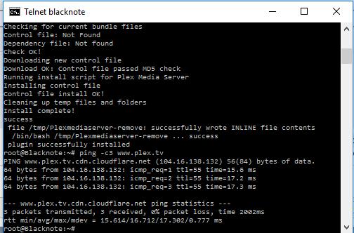

Been trying to install the Plex plugin for the last 3 hours, and I always end up with this when I got to config the gui
2016-10-03 14:32:54 [iNFO] *** Apply - Enable Initiated ***
2016-10-03 14:32:54 [iNFO] Stopping Plex Media Server...
2016-10-03 14:32:54 [iNFO] Stop OK: Not installed
2016-10-03 14:32:55 [iNFO] Updating settings
2016-10-03 14:32:55 [iNFO] Installing Plex Media Server...
2016-10-03 14:32:56 [iNFO] Updating dependencies
2016-10-03 14:32:56 [iNFO] No dependencies required for this application
2016-10-03 14:32:56 [iNFO] Updating export file
2016-10-03 14:32:56 [iNFO] Updating shorcut file
2016-10-03 14:32:59 [WARNING] Unable to get latest version from online - Checking USB for any install file
2016-10-03 14:32:59 [ERROR] Install failed: Install file missing
I'm using a cache drive and have been setting the install and library directories to /mnt/cache/appdata. I tried to do a clean install as well, but I get this every time. Any ideas?
Can your server reach the internet? Specifically the plex download location?
I think so, I don't see why not, how would it test it? I'm not really that great with UnRAID.
ping -c3 www.plex.tv
Ping looks good. So why isn't grabbing the file?
5.05
plex is no longer supported on 5.x since they stopped releasing the 32 bit version
Is the only plugin I have that only works on 6 now.
