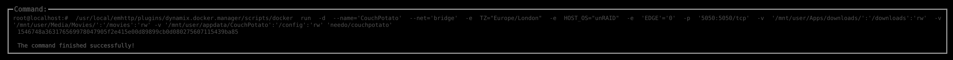

Can anyone offer any assistance to a Couch Potato problem that I have?
I've been using CP happily for about 2 years, then last month it stopped working, i get a "This site can't be reached" message along with a "err_connection_refused" description.
Get the attachment run command.
Thanks in advance.
Most likely is that the appdata is corrupted for the container.  You can try posting the logs from CP, (available on the docker tab by clicking uptime), but at the end of the day, the easiest solution may simply be to start it all over again fresh.

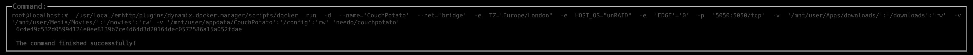

OK, I've made some progress (with the help of others) on resolving issues on my server, and now I call upon your assistance once more....
Can anyone offer any guidance on a Couch Potato problem that I have?
I was using CP happily for a while, then it stopped working, I get a "This site can't be reached" message along with a "err_connection_refused" description.
Screenshot of the run command attached.
Thanks in advance.
