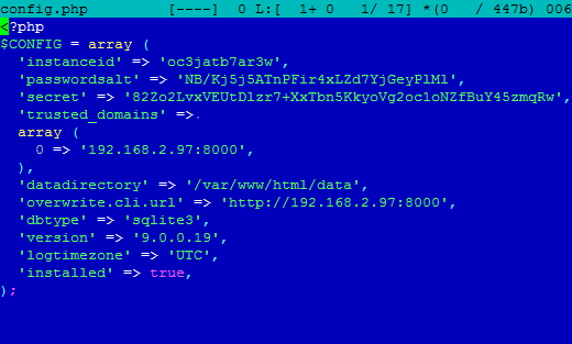

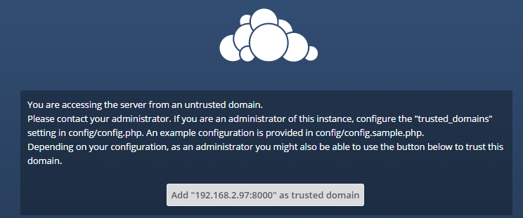

I am getting this error "You are accessing the server from an untrusted domain.".  I have searched this and ssh'd to unraid.  I looked at the config.php.  I am attaching the screenshot (I dont see anything wrong with it) of the config.php.  Can you please look at it and let me know if you see why I am getting the error.
Thanks
Bill
hunter69: You add the server address to the part after 0 => :)
Remeber it need to have the same ` around it as the one that is there and the port
my server address is 192.168.2.97:8000.  When I got the error initially I hit the button the add it as a same domain but it has never moved past the error.  Ideas or do you see an issue in the config?
Thanks again for taking the time to help.  I really appreciate it
Bill
aaa my fault :(
Bill
I am attaching the error that I see and the etire screenshot of the config.  I have stopped and restarted owncloud.  Ideas?  This is a virtual unraid server.  The error clearing indicates it wants it's own IP but the ESXI Server that it is on is 192.168.2.254.  Would that have anything to do with it?
I ended up fixing this error by changing the trusted domain from 192.168.2.97:8000 to 192.168.2.97.  That's it that fixed my issue
Thanks to all those that took the time to respond and help.

gfjardim, you seem to be the expert in setting up a reverse proxy. I have installed the owncloud docker from Bungy and the letsencrypt/nginx docker from Aptalca. Where is the best place on the forum to get advise in setting up a secure connection to owncloud via nginx? I have both dockers up and running (landing page in letsencrypt) but  https://192.1.1.100:8000 isn't working. Should I open s separate thread?

/oc/config/remote.php:
                                                                                                                                                                                   <?php
$CONFIG = array (
  'instanceid' => 'confidential',
  'passwordsalt' => 'confidential',
  'secret' => 'confidential',
  'trusted_domains' =>
  array (
    0 => '192.1.1.100',
  'datadirectory' => '/var/www/html/data',
  'overwritehost' => 'example.myfritz.net',
  'overwriteprotocol' => 'https',
  'overwritewebroot' => '/owncloud',
  'overwrite.cli.url' => '/owncloud',
  'dbtype' => 'mysql',
  'version' => '9.0.0.19',
  'dbname' => 'oc',
  'dbhost' => '192.1.1.100',
  'dbtableprefix' => 'oc_',
  'dbuser' => 'oc_user',
  'dbpassword' => 'confidential',
  'logtimezone' => 'UTC',
  'installed' => true,
Would be great to know how to debug and which log to look at. Additionally: which files to be modified? I guess that .htaccess need to be modified as well?
But maybe someone can already let us know what I made wrong in any of the config files?  ::)
