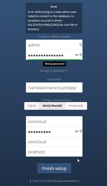

I can't seem to access the the WebUI. I get a Connection refused and I've let the docker run for quite a long time. There is nothing in the logs past:
160118 12:48:21 mysqld_safe Logging to '/var/lib/mysql/96c0209c5475.err'.
160118 12:48:21 mysqld_safe Starting mysqld daemon with databases from /var/lib/mysql
And the folders that are mounted are empty. I've tried restarting it multiple times but nothing seems to be happening.

Alright, I got the official container up and running. I think I was just too tired last night to approach this correctly.
Now to just figure out Redis and the Reverse proxy. I have DuckDNS all set up for other purposes, but the reverse proxy thing is entirely new to me.

Long story short, I had an existing owncloud docker installed and working for the last year or so.  Today, I decided to wipe my docker.img file and start fresh.
Using mariadb as a backend.
I created the user and db in mariadb with mysql workbench as follows
CREATE USER 'owncloud'@'localhost' IDENTIFIED BY 'ThePasswordYouWant';
CREATE DATABASE IF NOT EXISTS owncloud;
GRANT ALL PRIVILEGES ON owncloud.* TO 'owncloud'@'localhost' IDENTIFIED BY 'ThePasswordYouWant';
It returns successful and I can see the db and user.
Then I installed owncloud.  Owncloud installed fine and I can get to the web page at https://localhost:8000
data folder mapped from /var/www/owncloud/data/ in the container to /mnt/user/OWNCLOUD/data on the array
I select storage and database and select the mysql/mariadb option and enter the database id and credentials I used when setting it up.  I enter the admin account info that I want
I get this error:
Failed to Connect to the database...  SQLSTATE[HY000] [2002] No such file or directory
I read on the owncloud site that this is could be a problem with permissions on the owncloud.db file in the data directory ( /var/www/owncloud/data/), so I chmod'ed it to 777 and then 755.
Same error.
I've tried creating and using different databases and users with the same result.
The owncloud.log file in the data directory is empty.  I attached an image of the web page after the connection fails.
Does anyone have any suggestions?
Thank you!
2 things possibly..
Try the IP address instead of localhost in the owncloud login.
And depending on the error after that, you could replace 'localhost' during the DB/user creation process with '%' instead.
- NinthWalker
