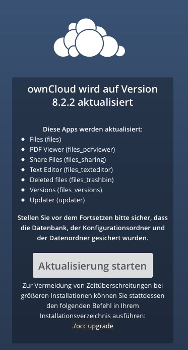

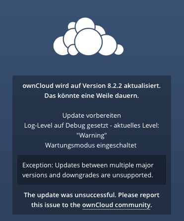

I recently had to restore /mnt/cache/.Docker/appdata/owncloud from my backup server ... good to have it :-)
I removed the Docker instance as well as the container and re-installed it from templates. The issue that I am no having is that ownCloud is coming up with a request for update (see pic.1). As soon as I click on the update button result is like in pic.2
This is what I see in the Docker log:
Found pre-existing certificate, using it.
NOTICE: ownCloud will now update.
ownCloud or one of the apps require upgrade - only a limited number of commands are available
You may use your browser or the occ upgrade command to do the upgrade
Set log level to debug - current level: 'Warning'
Turned on maintenance mode
Exception: Updates between multiple major versions and downgrades are unsupported.
Update failed
Maintenance mode is kept active
Reset log level to 'Warning'
Update done, quitting.
Is there a way to resolve that issue?
