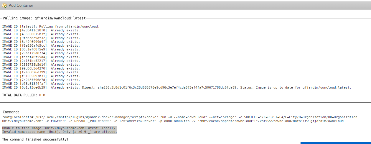

I am trying to install this version of  the owncloud docker.  I am receiving an error when installing it (attached).  Prior to attempting this version of the docker, I installed Bungy;s docker.  I removed Bungy's docker (including image) deleted its install folder.  I then attempted to install this version of the docker.  Any clue why I would be seeing this issue?
Thanks for any help
Bill
Thanks for any help
Bill
