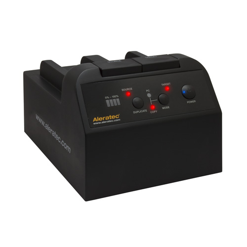

July 30, 201412 yr A good investment that will make your unRAID experience so much better: http://www.aleratec.com/1-1-usb-3-sata-hard-disk-drive-duplicator-dock-350123.html
