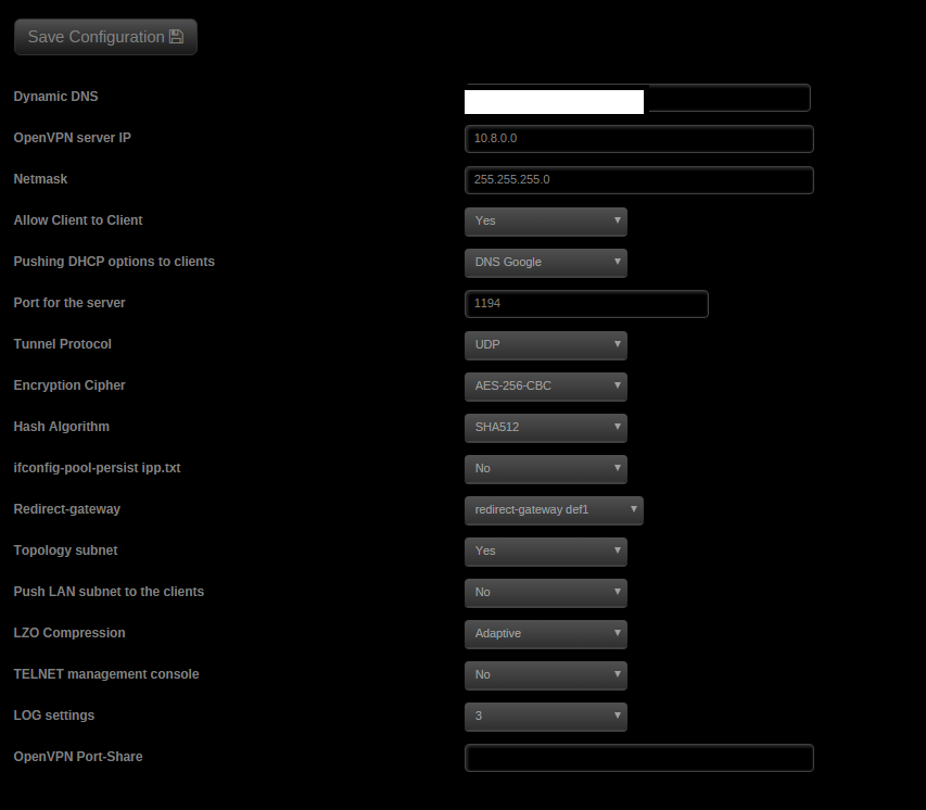

Hi peter (or anyone else who can help me),
I port forwarded port 1194 to my unraid's static ip, (192.168.3.111) but when I tried to connect using it a openvpn client it gives me a time out error. When I scan ports using a website it says that port 1194 is closed. And I am pretty sure that port forwarding is done correctly. (please check the attachments to make sure)
One interesting thing is that when i change the port openvpn server uses to 80, and run the server the website says that the port is open.
Thanks in advance for the help.

do you se any logs when client try to connect on the server? And the are client using a "in-line file" ?
Yes I am using the inline file, I just cut out the certificate part in the last post. Here is the whole inline client file:

Here are the server logs:
Wed Aug 17 15:21:23 2016 OpenVPN 2.3.11 x86_64-slackware-linux-gnu [sSL (OpenSSL)] [LZO] [EPOLL] [MH] [iPv6] built on May 10 2016
Wed Aug 17 15:21:23 2016 library versions: OpenSSL 1.0.1s  1 Mar 2016, LZO 2.03
Wed Aug 17 15:21:23 2016 Diffie-Hellman initialized with 2048 bit key
openvpn: symbol lookup error: openvpn: undefined symbol: SSL_CTX_get0_certificate

Are you on 6.1 version of unRAID ? if so the plugin will not work, you need to update your SSL packages. There is info from me with DL links some pages back.
//Peter
Where do I install these packages? Sorry, Im new to the unraid filesystem.
If you create a folder named extra on the flash, will be /boot/extra then copy the 2 SSL packages to that folder and then reboot. File on that folder will be automatic installed during boot.

Hey Peter,
I was on vacation this weekend, and used OpenVPN to watch a movie in the car. I used my Nexus 5X with an LTE unlimited connection that went all the way up to 25Mbps, with ping speeds of 43 milliseconds. However, the connection to the server through OpenVPN was capped at 2Mbps, resulting in a choppy playback of any video, even ones that were only a few hundred megabytes.
My server has a Gigabit NIC, and my connection to the outside world is 100Mbps. Below is a diagram
Server <----1000Mbps Gigabit NIC ----> Home Router <---- 100Mbps --> Internet <--- 25Mbps ----> Nexus 5X LTE connection
However, OpenVPN speed is capped at 2Mbps.
Is there something wrong with my settings? I'm ready to sacrifice some encryption for better speeds. I need a balance between speed and encryption.
I've attached a screenshot of my settings.
Thanks,
Eric
Don't know. you can try to disable encryption and se if that give you anything, just for testing, you need to create new client file.

I am having a really similar issue, if we can solve it, a beer is all yours.
Any help or ideas would be appreciated...
Do you think this applies??

Can you manually add this to server ovpn file and to the client file and test?  :)
//Peter

Try also modify only the server ovpn file with this lines.
sndbuf 0
rcvbuf 0
push "sndbuf 393216"
push "rcvbuf 393216"

I am going to go with no change... if anything maybe worse..
Tried both server/client, server only and client only.
This is my home internet connection where my Unraid Server lives...
This is my Samsung Galaxy S7 on a 4G network with good reception using the VPN on "redirect-gateway def1"
I normally get about 50 each way on 4G.
For the life of my I can't figure out what is bottle necking it, I don't have any special QoS or anything.
