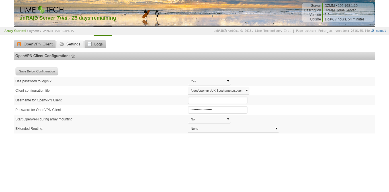

Create a folder /boot/openvpn and then copy your files to that folder. Start the plugin.
I must be doing something wrong.  I copied the files, entered my details but it didn't connect.  The southampton file has:
client
proto udp
dev tun5
remote uk-southampton.privateinternetaccess.com 1198
resolv-retry infinite
nobind
persist-key
persist-tun
cipher aes-128-cbc
auth sha1
tls-client
remote-cert-tls server
comp-lzo
verb 1
reneg-sec 0
crl-verify crl.rsa.2048.pem
ca ca.rsa.2048.crt
disable-occ
auth-user-pass /boot/config/plugins/openvpnclient/password.txt
status /tmp/openvpn/openvpn-status.log
After you have saved the settings and started the client, did you see any error log?
Options error: --ca fails with 'ca.rsa.2048.crt': No such file or directory
Options error: --crl-verify fails with 'crl.rsa.2048.pem': No such file or directory
Options error: Please correct these errors.
Use --help for more information.
I've installed the client and my pia file from the link above - do I get the missing files from above from your server plugin, or elsewhere?  Sorry if not understanding, but new to setting up a VPN this way
You need also the missing file. They shall be in the zip file from pia
Sorry, I'm not normally this dense...I'd never used MC before so I only managed how to copy one file at a time rather than the whole folder.
Works perfectly - thank you!
