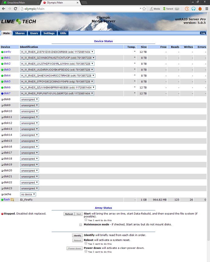

unRAID-Olympic-2014-1006-blue-disk7-67percent.jpg.1cefa917836104ce43973cccc7bd4daa.jpg
