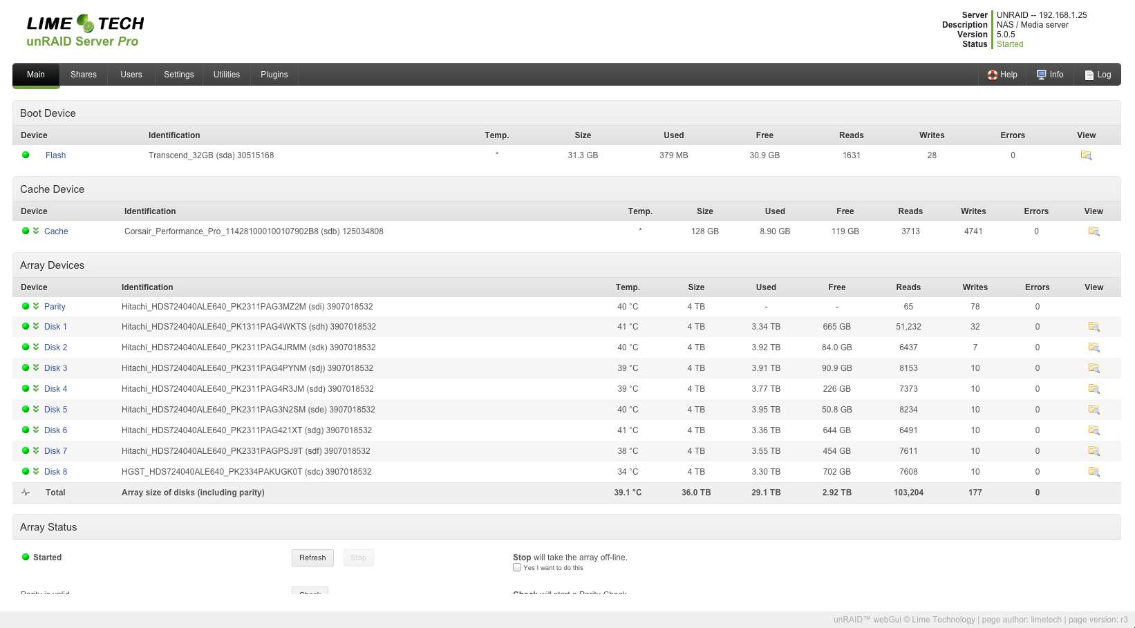

Thanks... i've used powerdown to shut down the machine. During shutdown i noticed a SMART report stating 'disk failure within 24 hours'....
When it was down gave it a good cleaning (lots of dust...) and re-plugged all disks and cables.
Now i have rebooted, and the gui does not show any errors...like nothing happened.
Looking at the smart status reports from unmenu, i see reallocated sector counts on disk 2 and 6. Disk 2 has failed smart:

So... what to do now? Should i replace disk 2 and do a rebuild? What about disk 6?
Anyone who can point me in the right direction?
What should i do, remove disk2 and replace it with a new one and rebuild?
But... since disk6 has read errors as well, won't that become a problem during rebuild?
I've just got me a new 4TB WD Red just in case.
I don't wanna be impatient but i really need some help/guidance/assurance. What should i do?
Anyone? Am i posting in the wrong section maybe?
At this moment i can not even copy data from disk2 anymore, it is extremely slow, and the webgui shows errors are generated when i do. So there is no way to copy stuff from it, i have to replace disk2 and rebuild it from parity i guess.
Disk6 i can still copy data from, i have enough room on the array to move it's content and do a poor man's backup. If needed, disk6 could be omitted. So if there is a way to remove disk6 before i rebuild disk2, so disk6 won't be a hazard?

You cannot remove any disks if you want to be able to rebuild disk2 from parity.  If you have a spare drive available then I would do this ASAP before something else goes wrong.  Since you have another drive possibly playing up it is possible the rebuild will not be perfect (i.e. some files corrupt/missing) but at least you will have recovered what you can.
As you say you have copied data off the other suspect drive (disk6), then once you have rebuilt disk2, you could do a 'new config' and re-assign the drives omitting disk6.  The 'new config' will destroy the current parity (which is why you need to rebuild disk2 first) but should then leave you with a known working set of drives albeit without parity at this point..  After doing the new config you will have to do a parity sync to create a new valid parity, and after that you should run a parity check to validate it.
Once you have the current disk6 out of the array you can put the drive through a few pre-clear cycles to see if it is really failing and needs replacing or not.
Disk2 should not be re-used as in my experience any drive that fails SMART is in imminent total failure (unfortunately the converse is not true).  If it is still under warranty the fact that it is failing SMART is more than enough reason to ask for a replacement.
Clearly you need to rebuild disk2.  Hopefully you have backups of your data -- if not, you'll just have to run the risk of losing all of disk2's data until the rebuild completes because, as you've noted you may have a 2nd failing drive as well.
If the disk2 rebuild completes okay, I'd then do the same with disk6, so you have both of your troublesome disks out of the array.
Disk2 should not be re-used as in my experience any drive that fails SMART is in imminent total failure ...
Absolutely agree.  If a disk fails SMART, do NOT use it - period.  Time for the trash can or (if under warranty) an RMA.
OK, loud and clear, thanks!
I do not have a full backup, so i take the risk of losing all of disk2 data, i am aware of that.
I guess i'll have to run the preclear script on the replacement for disk2 first? That will take a day or 2 as well :(
I'd turn off your server and not use it until you have the new disk tested and are ready for the rebuild.
A pre-clear isn't absolutely necessary (it's just one way of testing the disk) ... but you should at least confirm the new disk is okay.  To minimize downtime, I'd just run the WD Data Lifeguard tests -- Quick, Extended, then a full write zeroes, and then repeat the Quick and Extended -- on a convenient PC.  Connect the drive directly to a SATA port ... that's FAR faster than using a USB caddy.
I don't have a esata cable... so i will test the new wd red using a usb docking station.
In the mean time i am still copying some stuff from disk6 as much as i can, just to be sure.
After that is done, and the new WD red is ok & ready, i will replace disk2 and start the rebuild as stated in the wiki.
Thanks so far guys!
I've downloaded the wd diagnostics, but the extended test and the full zero write will take about 70 hours each... over usb. So if i have to do both tests twice, i'll be litterally busy for the next 3 weeks...
I think i better put the wd red in the unraid machine and do a preclear from there... that will take a day and a half, for one run.
If i don't want to use the unraid server's storage while preclearing, can i just leave it or should i stop the array while preclearing?
Actually you don't need to do two of the extended WD tests.
Just do a Quick test; then a full Write Zeroes; and then the Extended test.
However, if you do these over USB, they do indeed take a LONG time.    If you do them from a SATA port, they're MUCH quicker -- actually a good bit quicker than a pre-clear.    Does your PC not have any spare SATA ports?    You don't have to actually put the drive in the machine -- just attach a SATA cable to it, plug it in a spare port; and plug in a SATA power cable.
But if you prefer to use the UnRAID machine, that's fine.  I wouldn't do anything with the array, however => it's okay to Start it (or not), but don't USE it.  No need to take any chances with more use of the two failing drives until you get this resolved.
I don't have a pc, only a mac mini, and a windows laptop. The laptop has a eSata port, but i don't have a cable for it...
I hurried to the local pc shop yesterday to get the 4TB WD red... i could have picked up a cable there :-\
In any event, you should pick up a cable when convenient (or just order one).    It's definitely something you should have so you can attach drives to the laptop when needed.
I will pick one up later this week, i'm gonna get a 2nd WD red for disk6 as well. If the rebuild succeeds that is.
Preclearing is in its final stage, post read, 40%. Probably gonna start the rebuild next morning (it's now 18:45 here in NL)
How long will a rebuild take? About the same time as a preclear cycle?
A rebuild should take roughly the same amount of time as a parity check.    Not nearly as long as a preclear.
Ok, so a rebuild will take about 9 to 10 hours, that's a lot better :)
I just found out the 4TB WD red disk is 52 bytes 'larger' then the parity and other (HGST) 4TB disks... the HGST/Hitachi's are 3907018532 bytes, the WD is 3907018584 bytes... will this become a problem for the rebuild?
Yes, definitely.  UnRAID won't allow it, as the parity drive must be >= all other drives in the system.
There are two ways to resolve this ...
(1)  Use the "parity swap-disable" feature; which allows you to replace a failing drive with the parity drive while at the same time upgrading parity to a larger drive.    This process is outlined in the Wiki.  Basically the system will first copy the old parity drive to the new one; then do the rebuild.
(2)  Attach your WD Red to your laptop (using the eSATA cable you're going to buy); and use the SetMax feature in the free HDat2 utility [ http://www.hdat2.com/ ] to make it the same size as the current parity drive.    The drive can then be used for a rebuild without the need to change your parity drive.
... Here's a copy of the Wiki page that outlines the swap-disable process:
You must replace a failed disk with a disk which is as big or bigger than the original and not bigger than the parity disk. If the replacement disk is larger than your parity disk, then the system permits a special configuration change called swap-disable.
For swap-disable, you use your existing parity disk to replace the failed disk, and you install your new big disk as the parity disk:
1. Stop the array.
2. Power down the unit.
3. Replace the parity hard disk with a new bigger one.
4. Replace the failed hard disk with you old parity disk.
5. Power up the unit.
6. Start the array.
When you start the array, the system will first copy the parity information to the new parity disk, and then reconstruct the contents of the failed disk.
Note, however, that there have been a few instances where folks say this hasn't worked correctly in v5.  I've not done it myself, so I don't really know => but the "Safe" way to do this is to do one step at a time ... i.e. do the rebuild of the failing disk; and THEN upgrade parity to a larger drive.    Personally, I'd use HDat2 to make the disk "okay" for a rebuild;  then, with your next WD Red, upgrade parity to that drive (or perhaps even spring for a 6TB unit for parity) ... and then you won't have issues with future rebuilds.
