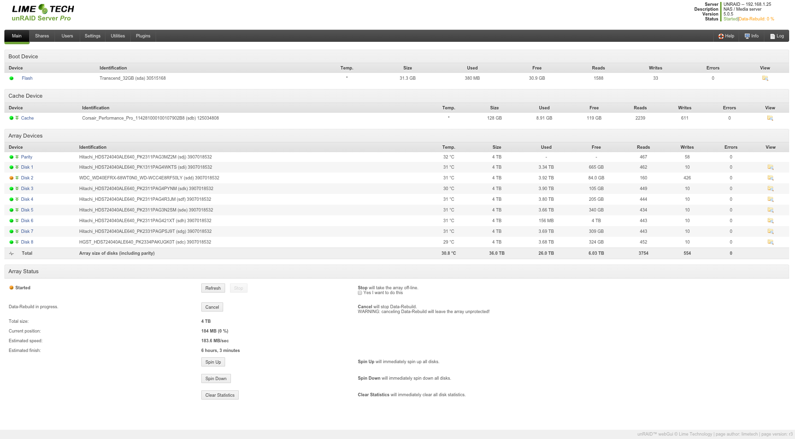

Could it be the unraid webgui is showing the wrong size?
The gui shows 3,907,018,532 bytes for a 4TB Hitachi, while the SMART report shows 4,000,787,030,016.
Preclear also shows 4,000,787,030,016 for the WD red... which would mean it would fit... it's exactly the same size as the Hitachi it replaces...
Sounds like it may in fact be the same size ... in which case it should work fine as a replacement drive for the rebuild.

Ok, after preclear finished succesfully i've stopped the array, replaced the suspicous disk2 with the new WD red. After restarting and assigning the WD red to disk2' slot, it said ' Wrong disk' with a red ball. Not totally what i expected according to the wiki, but i could choose to rebuild, and i continued. It is now rebuilding... fingers crossed :)
It's working fine -- that's exactly what it should show.
If it had a problem with the size, it wouldn't have started.    Note also that the disks are shown as the exact same size.    Not sure why you thought there was a difference, but the details on the Web GUI show exactly the same byte count for all nine of your array disks (parity plus the 8 data drives).
No, there is something wrong with the way the webgui shows the size.
Now the WD is part of the array, it shows the same size as the Hitachi's (3,907,018,532).
But when i was preclearing it, the webgui showed the WD as 3,907,018,584...
The SMART report for both drives showed 4,000,787,030,016....
There's nothing wrong with the sizes.  SMART is displaying the actual byte count in decimal.  The Web GUI is displaying it in KB.    Remember that disk drive manufacturers report sizes in decimal;  computers "count" in binary, which 1KB = 1024 bytes.
Note that 4,000,787,030,016 / 1024 = 3,907,018,584  ... which is consistent with what's displayed (the 52KB difference is because the actual partition doesn't use the entire disk to the GPT partition tables.
