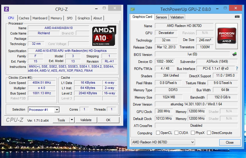

Sooo... I've hit a wall with my experiments and wonder if it's even possible. I've tried many kind of xml-configurations and when something gets better, something else gets broken. Argh, please help me! =)
What I have thus far:
-Fresh Windows 8.1 installation on KVM
-Kinda have a passthrough for my iGPU out of AMD A10-6700 (Radeon HD 8670D)
And here is when the trouble starts:
-Mouse pointer is not tracking well. (Not well at all, it's almost crazy and I have to swing the mouse multiple times out of VNC-window to get the pointer where I want. Mouse did work with the stock settings(created via WebGui -> VMs -> +Create) but something broke it after I tried to get the gpu passed through.
-Everything is very choppy. I'm using wireless to connect it, but it's 802.11ac(on my desktop) and should be more than enough.
-GPU passthrough is not really working. I can see that device in Windows but drivers do not work with it and it does not activate. What did I miss?
What I've tried for example:
-Disable Microsoft Basic Display Adapter to get Radeon Activated after restart -> Nothing.
-Remove <video> lines from windows8.xml -> They'll get autogenerated after I start the machine in WebGui.
-Remove <video> and <graphics> from windows8.xml -> No idea... Now I can't login to that VM because I would need VNC for it. At least they won't get autogenerated at this point. =)
What is the best way to connect to Windows 8.1 KVM that has a GPU passthrough? My unRaid server is a small headless ITX-case and I'd like to keep it that way. I just wanna connect it externally, using putty, vnc(or something else?) and webgui.
U can see the screenshots(driver problem) out of that VM in HERE

I took a screenshot of Cpu-Z and GPU-Z and their values. It's in the attachments.
Edit: When I took that screenshot, all my cpu-cores didn't passthrough I suppose. I edited this:
  <cpu mode='host-passthrough'>
  </cpu>
To this:
    <topology sockets='1' cores='4' threads='1'/>
  </cpu>
And Cpu-Z can see all 4 cores, just like Windows. Everything feels a tiny bit snappier once again, even on desktop. =)
