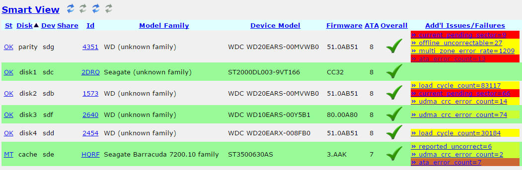

This is great!  Thanks very much for the help.
Should I just be running the short tests?  I didn't even know about these tests, but I will run them now to see what results I get.
I am attaching the Smart Test for the other drives.  They seemed to all be completed without errors, but you mentioned about pending sector and on SDB I see 66 in pending (if I am reading that correctly).
My question is, do I have any issues with the other drives?

I am also attaching a screen capture of the Smart View of the drives.  I tried to attach it to the previous post, but I could not include additional attachments for some reason.
Do you have current backups? If not, I'd back everything up now before doing any drive replacements with the array. You have 2 drives with pending sectors, which may prevent a successful rebuild. It's not a guaranteed fail, but it doesn't give me the warm and fuzzies. Ideally drive problems should be dealt with as soon as they come up, because unraid requires perfect reads from all but 1 drive to rebuild that failed drive. Currently the stock GUI doesn't emphasize drive health enough, but that is changing in the 6 beta versions. The smart report screen from myMain in unmenu is a very good place to keep up with drive health right now, as your screenshot shows.
I'm open to all suggestions.
So what you are saying is that 2 drives are potentially falling?  The parity plus 1 other?
I currently do not run any backups and I honestly wouldn't even know how to back up this data.
I basically set up this unraid server added some plugins and was essentially hands off the last 3 years.
Looking for advice on how to proceed.
You mentioned buying a 4tb to replace the parity.  I can certainly do that but not sure what to do with the existing parity drive or the other problematic one.
Thanks
Since you haven't gotten a reply, I will tell you what I would do it.  (First, you will be buying two disks to replace these disks.  So be looking around and evaluting what you need and can afford.  If you will be needing more storage capacity in the future this would be an excellent time to get two 3 to 6TB drives.)  Now for the procedure:
1- On the 'Main' page of unRAID's webGUI, double click on disk 2.
2- Under the SMB properties, make 'Export' 'Yes' and 'Security' 'Public'
3- On your windows machine, double click on Network and select your server by name.
4- Open 'Disk 2' and copy all the files off that disk.  (You may have some failures-- data loss-- if both Disk 2 and your parity drive have issues in the same respective blocks.)
If you don't have room off the server, you could try to copy some data from disk 2 to other disks on your server.  With your parity drive in its current state, I would not really recommend doing this accept under extreme circumstances!
Another option would be to be to simply preclear both disks and install them without attempting to recover any data from Disk 2 while it is still in the array.  Install a utility (I am aware of two that will do this) which will read your disk 2 in your windows.  You can then copy the files back to the server.  Using this option will guarantee that you lose data!

You are going to be replacing both the parity and disk 2 at this point.  The odds are not fifty-fifty that either of the two drives can be used reused.  The simplest way to find out if a drive is garage is to try to run three cycles of the preclear script and see if the number of errors (and the type of errors) remains constant after the first cycle.  (The last disk I had fail would not even start the preclear script!)  Basically, you are attempting to figure out if the disk is failing very quickly or if it still has a few months of usable service left in it.  (Realize that all hard drives WILL fail.  The trick is to figuring out when!)

I'd spend a few extra $$ and get NAS-rated drives -- either WD Reds or the HGST units.
http://www.newegg.com/Product/Product.aspx?Item=N82E16822145912
http://www.newegg.com/Product/Product.aspx?Item=N82E16822236599
The WD Reds run a bit cooler, but the HGST are a bit faster.  Both have excellent reliability records.
