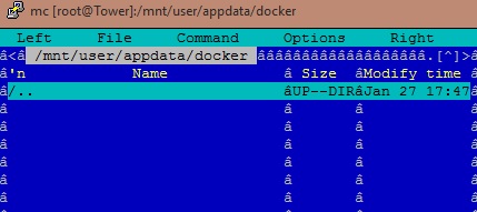

does the path /mnt/user/appdata/docker exist? (exactly how you typed it?)  If the path does not exist, then it can't create the docker.img file
syslog attached.
ps: was able to change notification options and turn scheduler on and this survived a reboot, so i assume settings are being written out ok
definitely matches exactly, this is where my docker.img was residing happily in B13 before the update

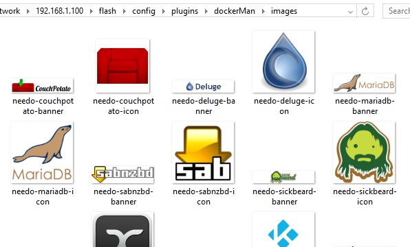

The icons for the apps are stored on your flash device, not inside the Docker image itself (under config\plugins\dockerMan\images).  Can you confirm that folder is present and that images are inside there for me?
all images are there
Ok, if you add a NEW application (one that you didn't recreate from template) does that work?
Also, if you hit "check for updates" and then apply any updates that show available, does that change anything for you?
The latest images seem to be updated when the Dockers are updated.  The image files should have a date of today after you update.  There are images left over from previous Dockers.  The current image files should be .....-latest....png.
I have re-installed CouchPotato so far from my template and there is no updated image, or image with todays date/time on it
Maybe reggie should just try adding "-latest" to the end of each image file for a "dirty fix" ;-)
I love it when you talk dirty
A quick way to find what image the Docker is looking for is to right click on the Docker web page and select view source.  Then search for '.png' and look for the image file that the webpage is expecting to load for the Docker.  You might be able to figure it out from there.
If you use google chrome and want to make this even easier, right click on the image that doesn't load and hit "Inspect Element".  Should do the same as view source but take you right to that element as opposed to having to scroll through the page to find it.
