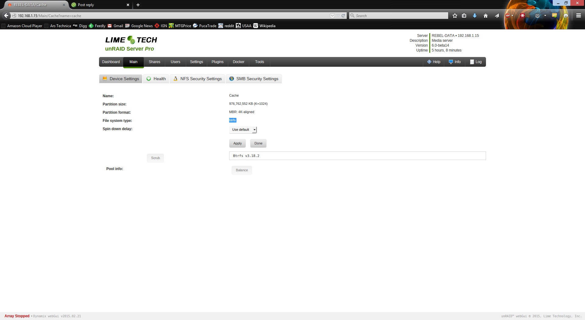

How did you convert your cache to XFS?  I moved everything off the cache, shut down the array and tried to change the drive status from btrfs to xfs, but it wouldn't let me.  Thanks!

Usually that would do it, but now when I stop the array and go to dial settings, I can't change the format. Very weird.

Are you setting the format on the cache disk itself?  Click on the far left "Cache" symbol on the cache drive page and you can then set the format for the cache disk.  The array has to be stopped first.
From what I remember, you have to stop the array, unassign the cache disk, start the array, stop the array, assign the cache disk and select the format, then re-start the array and it should re-format the cache disk.

Hmm. Can you post a screenshot?  Changing filesystems has been in the GUI since we included the options for alternatives to reiserfs.
Please see below.  Array is stopped, but I can't change the file format.
I've unassigned it, started the array, stopped the array, re-assigned and I still can't change it.

In addition to just disabling the cache drive(s), you need to actually change the number of available drives to "none", then start the array.
Stop the array, come back and re-enable the cache drives and then the option to change the file system is available to select.

When you stop the array for some other reason and restart... BAM... back to BTRFS.

After changing the file system, did you confirm formating of the drive (see Array Operations page) ?
Yes. It reads as XFS. But when you stop the array it "reverts" to BTRFS.

It should say there is a unformatted disk (name is listed), and ask you to do a format, this will take a couple of minutes to complete.
You are saying that after this it all reverts back to BTRFS ???

Correct. It goes through formatting, says XFS, then the next time the array starts it says BTRFS. ????
Did you have a cache pool previously? If yes, is it possible to convert any former cache pool drives to XFS ?
