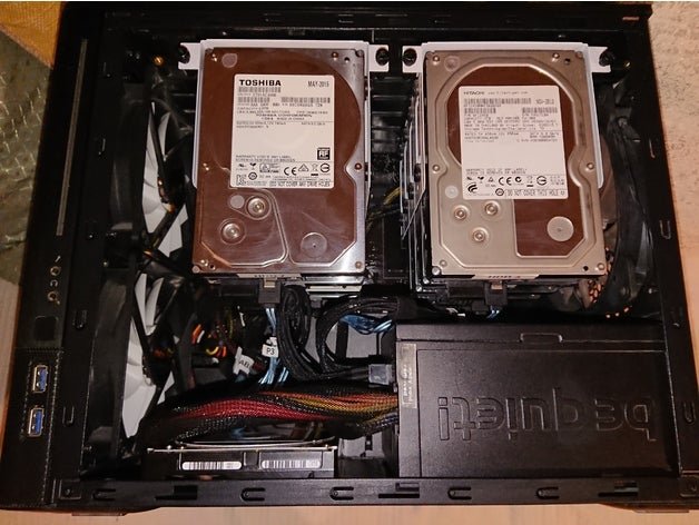

flaggart Posted March 10, 2015 Share Posted March 10, 2015 Hi all, I am trying to cram as many drives as possible into a Node 804. It has 8 hard drive bays plus room for two in the main chamber. I have fit 4 in the main chamber using OWC Multimounts, giving 11 data drives plus parity and a SSD for cache connected via the eSATA port on the motherboard. There is room for at least one more drive above each pair in the main chamber (which would take it to 13 data drives) but I don't know how to mount them securely. An adapter such as this would probably do the job but it looks a bit flimsy, and is half way around the world from me.. Any idea on alternatives for this? Case: Fractal Design Node 804 Mobo: ASRock fm2a75m-itx CPU: AMD A6-5600 Controller: Supermicro AOC-SAS2LP-MV8 Quote Link to comment
Chugiak Posted March 10, 2015 Share Posted March 10, 2015 It looks like any solution is going to be pretty custom. I'm not familiar with the Node 804 but it appears that you could run a brace or piece of metal across the span over the CPU. You might be able to screw into the case fans on either end to secure the brace. You could then suspend two drives above the CPU. It would restrict air flow, but would keep the drives cool! Quote Link to comment
yelnatsch517 Posted March 12, 2015 Share Posted March 12, 2015 How are you mounting the OWC Multimounts into the main chamber? Quote Link to comment
flaggart Posted March 13, 2015 Author Share Posted March 13, 2015 The underside of the case has holes for screwing directly into the bottom of the drives Quote Link to comment
flaggart Posted March 13, 2015 Author Share Posted March 13, 2015 I have ordered two of the 3-drive mounting cage/brackets pictured in the original post from http://eshop.macsales.com/item/Newer+Technology/G5MOUNT3HD/ I'm hoping these will let me fit 6 drives in total in the main chamber instead of 4. I'll then need two more free SATA ports and will have to swap the mobo - the current one only has 4. I can then squeeze an extra two drives in using the OWC Multimount, placed in the second chamber secured by Velcro (which came with the case, currently occupied by an SSD but this can be moved into one of two 2.5inch drive bays) - but again I'll need an extra 2 SATA ports. The plan is to get a mobo that also has a mPCIe slot so I can put in a card such as this: http://www.hwtools.net/Adapter/PM362.html If all goes well this will take the Node 804 up to 15 data drives + parity + cache. Quote Link to comment

flaggart Posted March 16, 2015 Author Share Posted March 16, 2015 Unfortunately the NewerTech G5 3-drive bay is a few mm too tall which means it will not fit in the main chamber beneath the controller card. So realistically all I can do is fit two more drives in the drive chamber using another OWC multimount - that would mean 13 data + parity + cache. Still not too shabby for such a tiny box! Quote Link to comment

maxse Posted April 10, 2019 Share Posted April 10, 2019 On 3/16/2015 at 6:43 AM, flaggart said: Unfortunately the NewerTech G5 3-drive bay is a few mm too tall which means it will not fit in the main chamber beneath the controller card. So realistically all I can do is fit two more drives in the drive chamber using another OWC multimount - that would mean 13 data + parity + cache. Still not too shabby for such a tiny box! @flaggart I got the OWC multimounts thanks for the tip! But how do you mount them in the drive chamber? I don't see any holes to mount the drives to in the drive chamber, only in the motherboard chamber. I want to set it up all at once even though I don't have that many drives yet, to make it easier in the future Quote Link to comment
flaggart Posted April 10, 2019 Author Share Posted April 10, 2019 I just used the velcro straps that were already there - I think they are supposed to be for cable management, it wasn't the greatest arrangement. I just settled for one drive there. Quote Link to comment

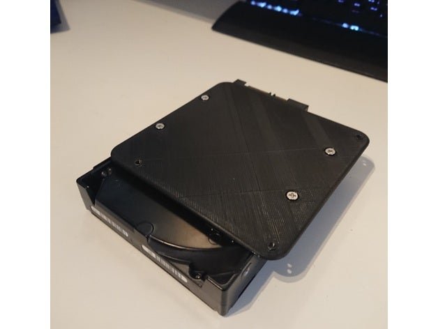

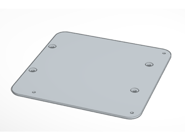

stuntman83 Posted January 12, 2020 Share Posted January 12, 2020 Hi I needed room to add a 2nd parity drive, as unraid at the time of my build did not have the dual parity feature. I squeezed the extra hdd in behind the psu, and made a custom 3d printed bracket to screw in to the holes used by the velcro. It's available on thingiverse thing:4095147 (https://www.thingiverse.com/thing:4095147) if this is still of interest to anyone 😀 Quote Link to comment
