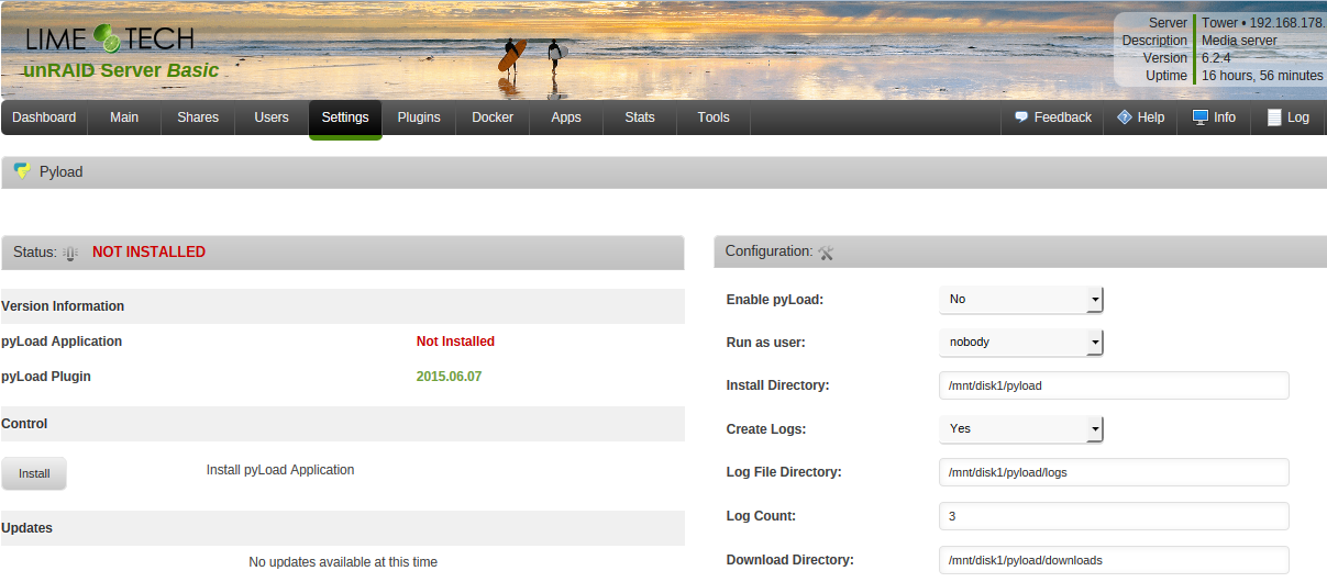

I have a problem with the pyload v6 plugin.
After installation of the plugin I go to Settings > PyLoad and click the "Install" button to install the "pyLoad Application".
However nothing happens.
Also I can´t change the settings on the right side, after "Apply" they reset to default values.
Please see the attached screenshot.
NONE of overbyrns plug-ins are compatible with unRaid 6.1+
You should uninstall all of them and instead switch to utilizing docker applications or PhAzE's plugins.  You will only ever see compatible plugins via the Apps tab
Thanks for the info!
Do you know of a compatible docker / plugin for pyload or other download manager?
Have not found anything else on google with "unraid download manager".
Install Community Applications (link in sig) and look in there
