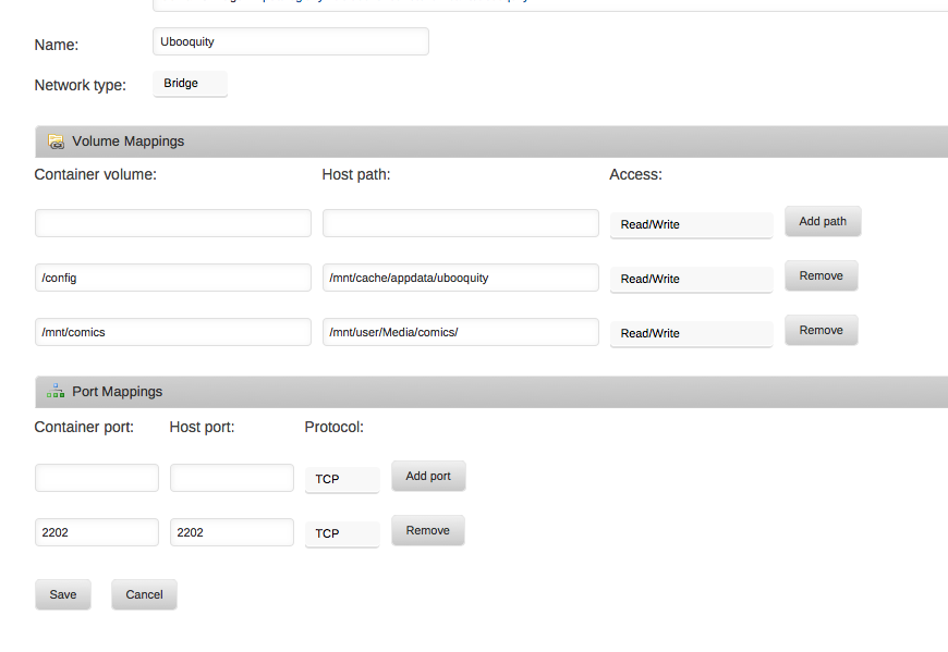

I think something broke with the Ubooquity docker.
I did a manual replacement of the .JAR file to manually upgrade to the newest version 1.10.1
Upgraded Java to version 8 via the dropping the install into the "extra" folder.
Now it won't load at all "site can't be reached, refused to connect" error.
This happens before and after the update to Java version 8.

The template is taking us to the wrong port for the WebUI
      <Port>
        <HostPort>2202</HostPort>
        <ContainerPort>2202</ContainerPort>
        <Protocol>tcp</Protocol>
      </Port>
<WebUI>http://[iP]:[PORT:8085]/admin</WebUI>
Did you update the template?  The container got a major overhaul.  A new template is required.

I removed the container and image then re-added it with Community Applications. Why does the template on your github say
if it is supposed to be 2202? On the Dashboard, if I click on Ubooquity and select WebUI, it takes me to 8085. If I manually enter the url myself and tell it to go to 2202 it works fine. So it seems like the template is telling us to go to the wrong port when we select WebUI from the menu on the Dashboard.
Ah that explains the problem i was having with Ubooquity also. Removed container and image, deleted template, added from CA again, and all good now.

Sorry to be so dense, but I've been looking for info and I can't find squat. Not sure I understand the statement.
I also don't know that I removed the old one properly. I removed the container and image, but I guess I didn't remove the template cause I have no idea how to do that. I only have one template repo set, but I don't think that's the same thing.

Thanks. I read through the update/upgrade parts, but that doesn't exactly tell me how to update Ubooquity to the latest inside the container. Unless I'm missing something - totally possible.
Also saw an update pop-up in unRAID for the container so I updated, but Ubooquity is still the 1.10.0 version and not the updated 1.10.1 with the bug fix. So I'm guessing this build was just to get ready for the automation you have planned?
Drop into the command line.
and execute the following:
docker exec ubooquity udpate
Replace ubooquity with the name of your container.
