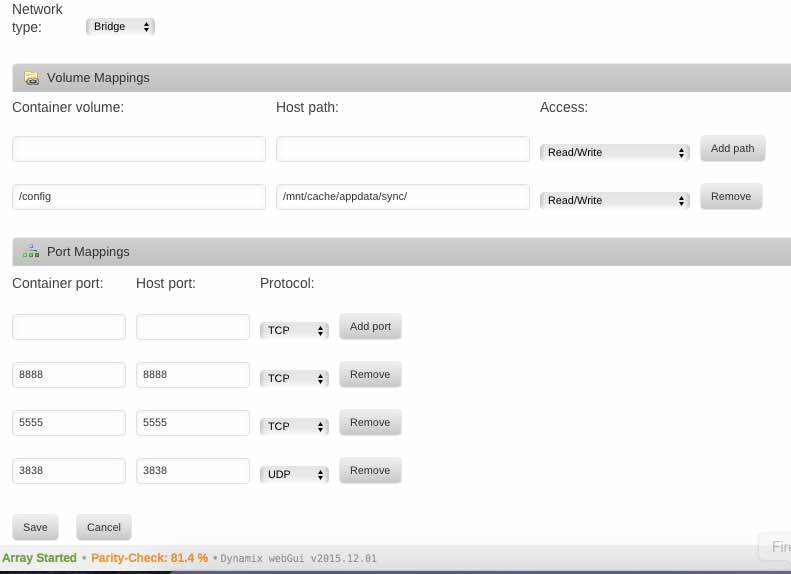

What are your volume mappings for this docker?
/mnt/cache/appdata/sync/
...is mapped to what exactly?
And is that the only volume mapping you have for this container? If so, that is the problem since that is the only folder the container will have access to.

Probably better post a screenshot that shows both the container volumes and host paths for this docker.

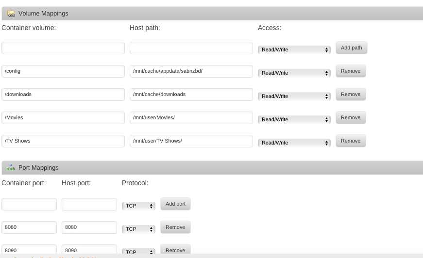

Here you go.  Yes I have other dockers working  here is sab also
So since you don't have any mapping for /mnt/user/music the container has no access. The only thing the container has access to is /mnt/cache/appdata/sync/, which it sees at /config. Get it?
Got it, I feel stupid now.
