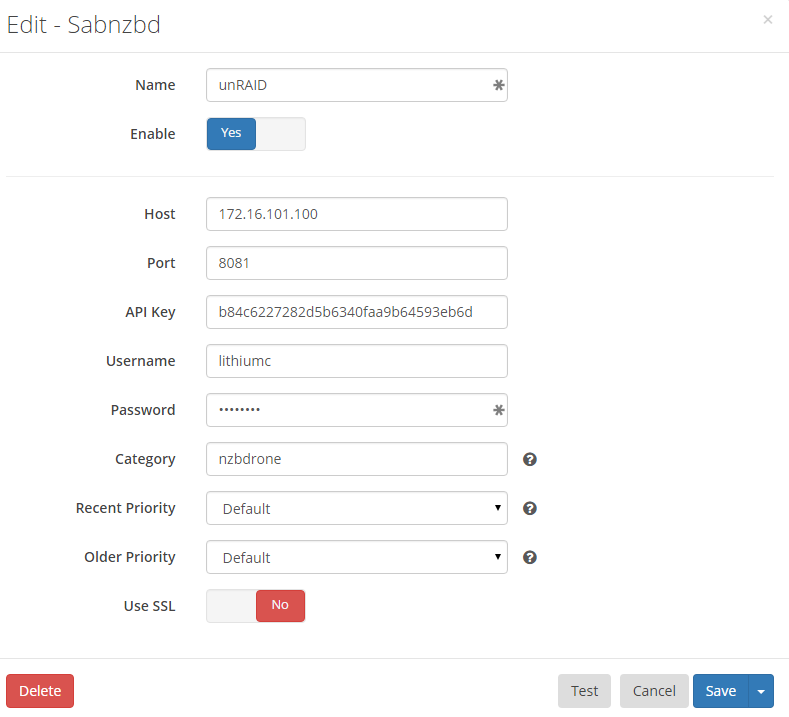

if i fill in the ip of my unraid in sonarr, i get a message
Test was aborted due to an error: Unable to connect to SABnzbd, please check your settings
no sorry
can you tell me what i should do?
That should work, I would restart sonarr and try again. I have attached a screen shot of my settings. 172.16.101.100 is the ip of my unRAID box.
