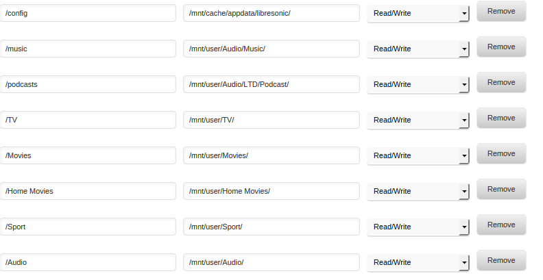

Sorry... was basing it from this:
In the log while it is running I get this constant error:
Starting Libresonic..
[GC (Allocation Failure) 64512K->3743K(245760K), 0.0052500 secs]
[GC (Allocation Failure) 68255K->2827K(245760K), 0.0057971 secs]
[GC (System.gc()) 60485K->7764K(245760K), 0.0140836 secs]
[Full GC (System.gc()) 7764K->7358K(245760K), 0.0261208 secs]
[GC (Allocation Failure) 71870K->31702K(245760K), 0.2201561 secs]
[GC (Allocation Failure) 96214K->53663K(245760K), 0.0734490 secs]
[GC (Allocation Failure) 118175K->71535K(209920K), 0.0217174 secs]
[GC (Allocation Failure) 100207K->87023K(227840K), 0.0089186 secs]
[GC (Allocation Failure) 115695K->94338K(227840K), 0.0189064 secs]
[GC (Allocation Failure) 123010K->98605K(227840K), 0.0115722 secs]
[GC (GCLocker Initiated GC) 105820K->97285K(227840K), 0.0207835 secs]
[GC (Metadata GC Threshold) 103195K->97817K(227840K), 0.0145474 secs]
[Full GC (Metadata GC Threshold) 97817K->41321K(193536K), 0.0883254 secs]
Repeating the entire time the Docker is running...I have increased the Java cache ENV variable to 250MB, but the error persists...
Should I ignore this or do you think there may be an issue with the docker??
Thanks again!

Thanks for all your work! Now that I've finally upgraded to 6.x (yeah... I know...) I've got an odd (to me) issue.
I installed your Subsonic docker, and couldn't for the life of me get Subsonic to see my media directories. (I've had a Subsonic license for years now.)
After fiddling with it for a couple of days, I gave up and installed the Libresonic docker. I added a /Music mapping to the dock, and by the time I'd gotten the web page for Libresonic loaded (after fiddling around, browsing the Libsonic Git page, finding that it defaults to port 8080, then discovering that it's actually running on port 4040 on my machine), it had already cataloged all my music. I've since restarted the Libresonic with mappings for all my media files and my daughter is watching a soccer match from her dorm room now.
The screen shot is of my Libresonic volume mappings, but they are the same as the ones I had for Subsonic. Any idea why one works and the other doesn't?
