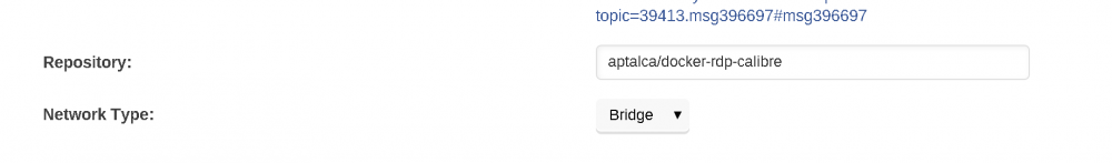

So I'm new to docker, new to unRaid, etc. I was trying to set up RDP-Calibre, but when I try to set my library to /config on first boot in the Calibre wizard in the WebUI, it gives me an error that the folder is not empty and that the library folder must be empty. What am I missing here?
/config is where the application data is stored rather than the library.  I've used a /books folder for my library, like so.

Thanks for the reply. I was trying to do the step in the docker hub instructions that say this:
  • IMPORTANT: On first start, select "/config" as the library location in the Calibre wizard
I know you can set up a different path for subsequent boots, but it sounds like I'm supposed to select config as the location for the library for first set up in the wizard (not docker). Is that incorrect?
