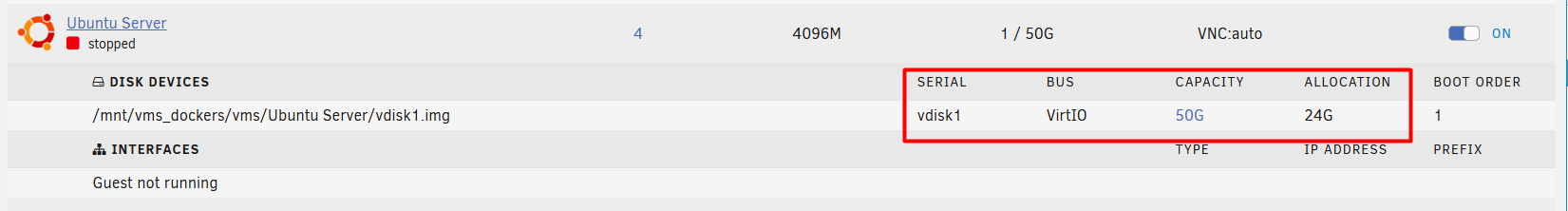

How do I do this on Ubuntu Server? How do I increase the disk partition?
Assuming you already made the allocation larger and want to expand the partition to fill it, the easiest way is to create a "utility" VM with all your management tools like gparted and such, then add the Ubuntu Server virtual disk as a second disk to the utility VM. Obviously the server VM must not be running while you work on it.
I'm sure there are command line utilities to accomplish it inside the server itself, but it's easier for me to just mount it to another VM.

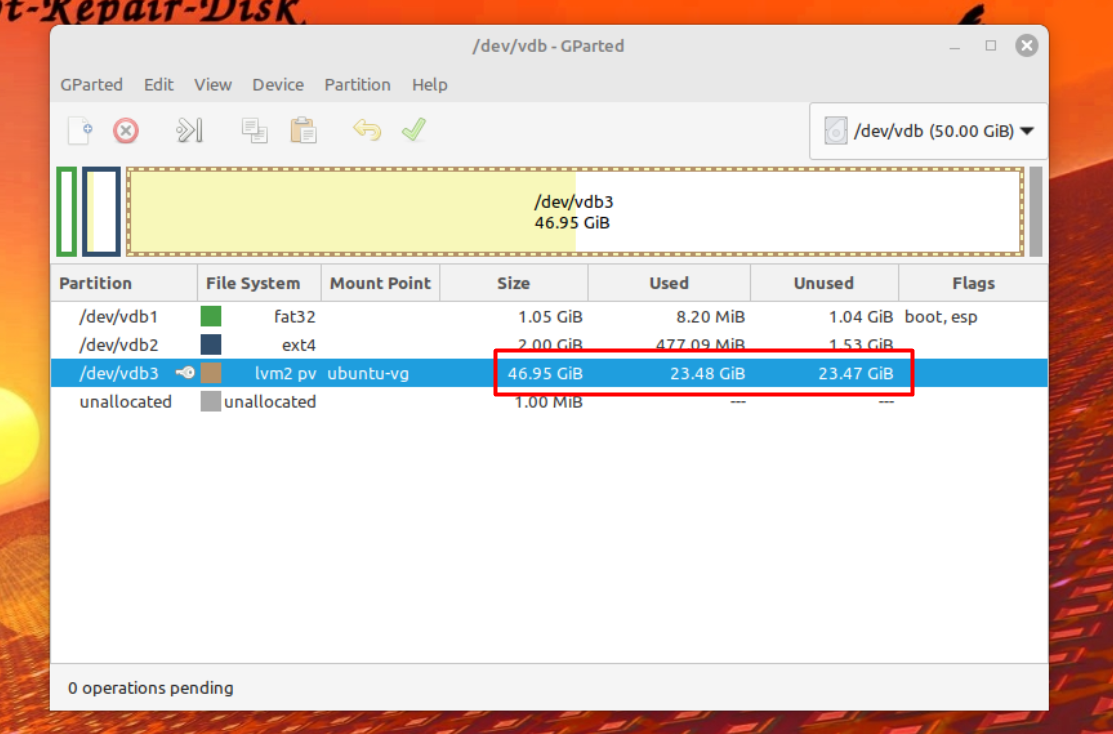

On 2/8/2025 at 5:19 AM, Kilrah said:
boot-repair-disk is a good tool for that., make a VM for it, select it as iso, manually specify the vdisk and point to the one of your ubuntu VM.
But growing can be done within the running system so you can just open gparted in that and grow your partition.

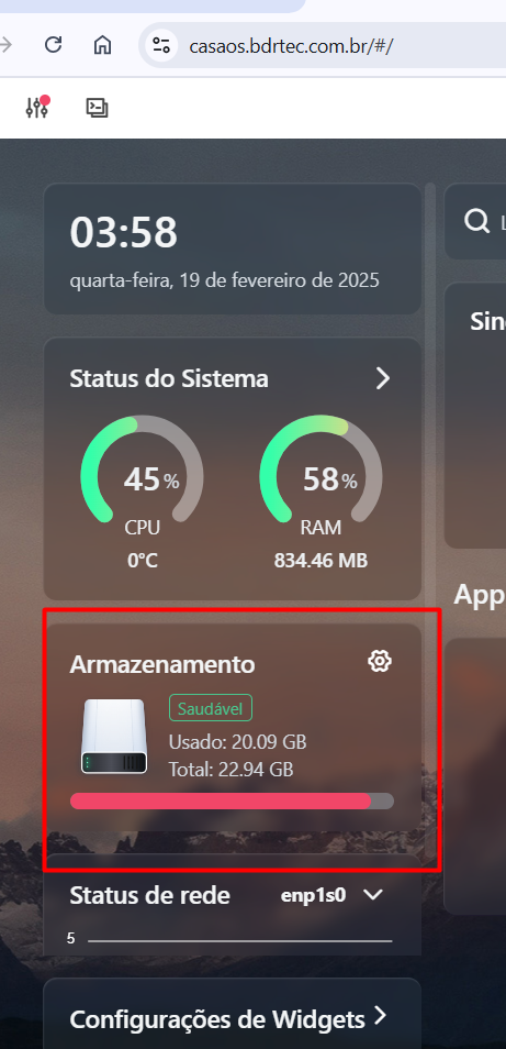

I installed it and checked that I have space left but Ubuntu is saying that there is no space
Edited by Braulio Dias Ribeiro
Looks like you're using an LVM so there's likely yet another step needed to resize that. I don't use that so you'll have to look up how.
