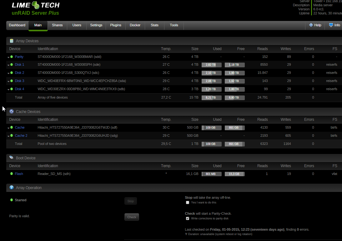

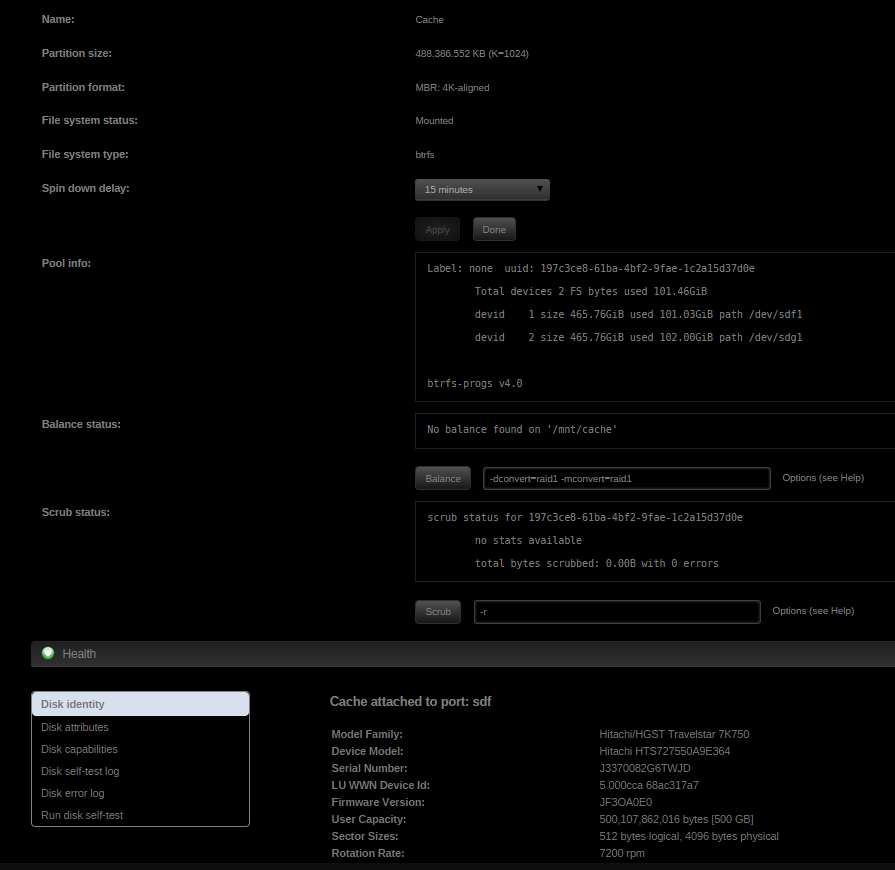

They show up fine and seem to be in operation - however, total size is reported as 1TB and attempts at running balance operation end with the user interface idling at 100% remaining and never updating. Accessing the log shows that a lot is going on under the hood. However, when all operations seem to be done (ie no more relocating of block groups showing up in the log), navigating away and back to the cache page shows "no balance found on mnt/cache" - which indicates to me that the pool is STILL operating as either JBOD or RAID-0 - and not RAID-1 which is what the balance operation should result in.

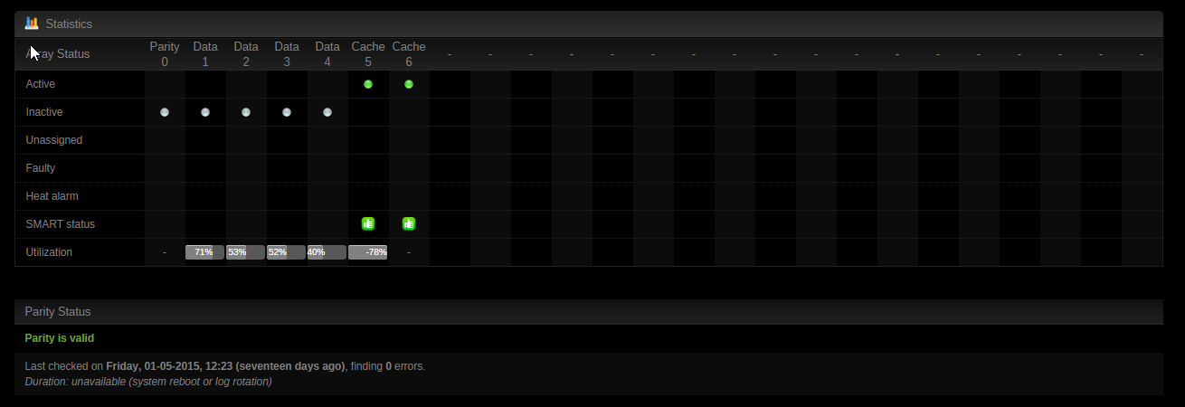

Just noticed a weird thing - according to my dashboard, my cache drive utilization is at minus 78%  :o
FYI, I think your raid 1 is fine. I think this is just a misunderstanding of what the "no balance found" means.
It means there is no active balance operation running. That is expected. If you look at the two devices in the pool above the no devices found, you can see that ~100GB of space is being consumed from each of the devices. There is a slight delta in the sizes because metadata is not stored in a RAID1 format.

Is there some reason that the main page enumerates the storage size to 1TB and not 500GB (which is what would be available if being RAID1)?

I have 2 x 120GB SSDs and mine shows 120GB total and 38% used on dashboard which is correct.

Main still shows two disks and a disk pool of 1 TB. Dash still shows utilization at minus 78%  :o
