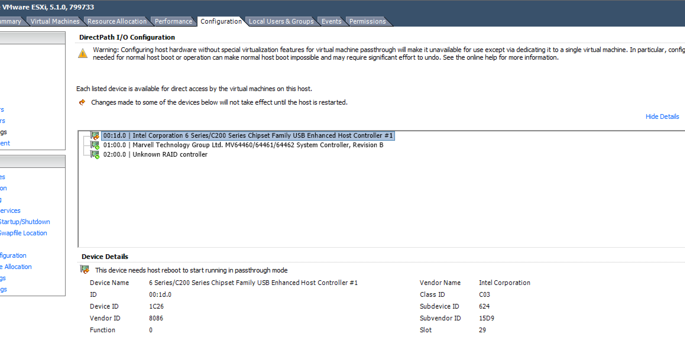

Add me to the list of people with the issue.  I did a fresh install of 6.0.1 last night on ESX6 with 2 hds and getting the really slow web gui and the reset errors.  I just haven't been able to start up yet as I am preclearing 2 8TB drives and I don't see a way to start without any assigned drives.
I have just done direct path io passthrough of the whole usb controller rather than adding a usb device and the issue has gone.  Web gui very fast no reset errors.  Only downside is plop will not boot had to use PlopKexec livecd now just trying to work out how to have it autoboot rather than needing to select to boot unraid.

I solved the problem by passing the usb controller on my X9SCM directly through to the unRaid vm.  I boot ESXi 5.5 U2 from the usb port on the mb so make sure you pt controller #1 (the ones on the rear I/O).  USB Controller #2 is for the internal ports (mb and mb header).
UnRaid boots from a vmdk image, so the USB only supplies the config folder.

I'm experiencing this problem as well.  I'm running Unraid 6 as a guest on ESXI 5.1 (and a supermicro X9SCM motherboard with SASLP-MV8 raid controllers).
However, I'm unable to pass through the USB controller -- when I set the value to pass it through, it doesn't 'stick' through the reboot.
