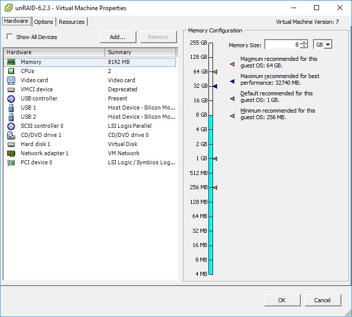

I upgrade from unRAID 5.0.4 to 6.1.7 back in January with no issues what so ever.  In fact the system has been rock solid for the last 10 months.  The last few weeks I have tried to upgrade to 6.2.1, 6.2.2, and 6.2.3, but the WEB GUI is extremely slow to the point of being unusable.  With 6.2.1 or 6.2.3 it typically takes 2 to 3 minutes for one of the unRAID menu pages to refresh (Main, Plugins, Stats, Tools, etc.).
I was getting the “usb 1-1: reset” error so I tried adding a second USB to my 6.2.3 configuration as others have tried.  It no longer has the “usb 1-1:reset” errors, but the WEB GUI is still extremely slow to the point of being unusable.
Current setup:
    Motherboard - SuperMicro X9SCM-F
    ESXi version 6.0.0 - build 4510822
    unRAID boots off a VMDK drive
    Guest Operating System setting in ESXi – I have tried both Ubuntu Linux (32-bit) and (64-bit)
I am attaching the log file that was collected with 2 USB sticks configured for the VM.  It is not showing the “usb 1-1: reset” error, but the system is still unusable.
20161103_-_UnRAID_6.2.3_boot_log_very_slow_w_2_USBs.txt

I'm not sure what you mean "unassigned devices plugin".  Can you provide additional info on how to configure this?  Attached is an image of the ESXi settings screen for my VM.
As some others have mentioned, the only way I got it working on 6.2 was to pass-through a second USB controller.  You can pick one up fairly cheap (well worth it get rid of the headache if you ask me  ;) ).
