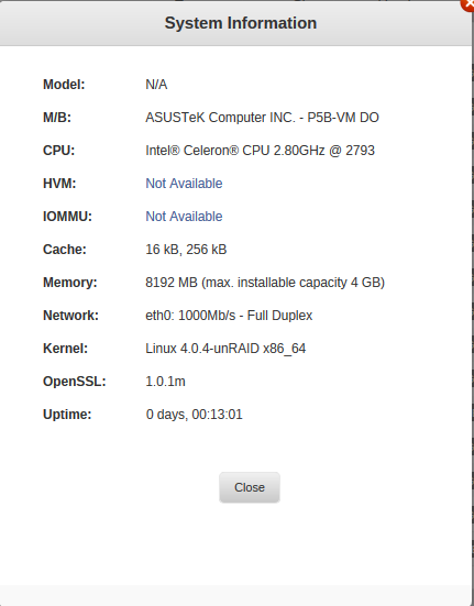

Info button says:
  Memory: 32768 MB (max. 4 GB)
but the dashboard reports:
  Memory size allocated 3291 MB
                        installed 8192 MB (max. 4 GB)
I also seem to be running around 80% memory utilization.
All this seems to suggest only 4gb is being used by unRaid.

I am having the same issue with Unraid 6. 12 GB of ram installed (and detected by BIOS) but seeing Max 4GB in UnRAID.
Dashboard Report:
Memory size allocated 12,018 MB
installed 12,288 MB (max. 4 GB)
Info Page Report:
M/B: ASUSTeK Computer INC. - P7P55D-E PRO
CPU: Intel® Core™ i5 CPU 750 @ 2.67GHz
HVM: Enabled
IOMMU: Disabled
Cache: 256 kB, 1024 kB, 8192 kB
Memory: 12288 MB (max. installable capacity 4 GB)
Network: eth0: 1000Mb/s - Full Duplex
Kernel: Linux 4.0.4-unRAID x86_64
OpenSSL: 1.0.1m
Yeah I don't know why they kept this "Memory" stat in there the way it is. It is incorrect on most systems. Both of mine show it wrong and have done so since it was introduced in one of the betas.
The information on the System Info screen comes from different sources, some of them real and some of them from the manufacturer.  In particular, the Max installable memory comes from whatever the maker plugged into the field.  Makers put a low priority on its accuracy, often not even filling in the Manufacturer or board or model name, so it's hardly surprising they didn't get the installable memory figure right.  I've suggested elsewhere that all info from the DMI (sometimes called the SMBIOS) be starred with an asterisk, with an asterisk note at the bottom stating the info is from DMI and may not be reliable.  For more info, see this.  For more info from Wikipedia, see DMI and SMBIOS.
The Max installable memory should not even be displayed if it comes from what the manufacturer put. That is never right. I imagine in most cases a larger size of ram has been introduced after the manufacturer set that number, or they just put the largest size they tested. In my few system builds that I tried larger amounts of ram than the manufacturer listed, it always worked just fine.
So to sum up, that field is almost never correct so why even use it? If something is incorrect more than 50% of the time, and this definitely is, I would not want to use or see it.
The problem is, we don't actually know what the percentage of accuracy is.  It's the old problem of, we only hear from those where it's not working.  When the number is correct, the user hardly notices it, as it is just stating the obvious.  Only when it's wrong does it become noticeable.
Something that bonienl could do is check the number for validity.  If less than installed memory, leave it blank.  Although then, a user might complain why their system info is different from someone else's.  bonienl will figure it out!    ;)
