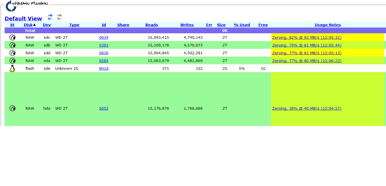

I am running preclear on 5 hard drives, they are all the same, and all plugged into sata ports on the motherboard. 4 of them are sda-sdd but the fifth one is hda and when running the preclear is going about half the speed. Does anyone know why?

Your syslog is filled with these "media errors" (unreadable sectors)
The speed is slowed way down since unRAID is resetting the disk and trying again and again on each failure.
