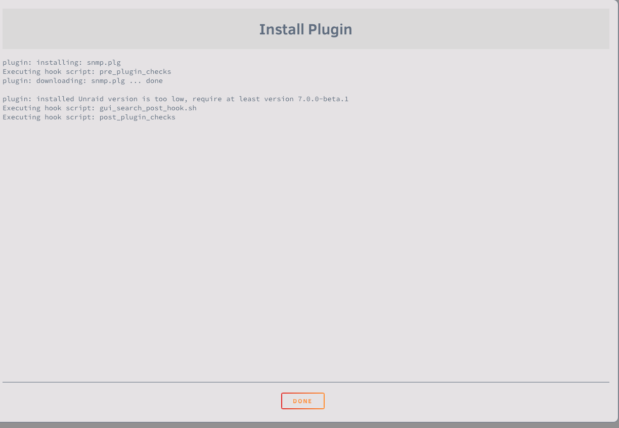

The plugin is incompatibile and can no longer be installed:
Is there a new solution?
See my response from a while back. Alternatively, feel free to add a pull request that adds switching logic and support for both versions of Unraid. The open-vm-tools plugin could provide a template for how to do this.

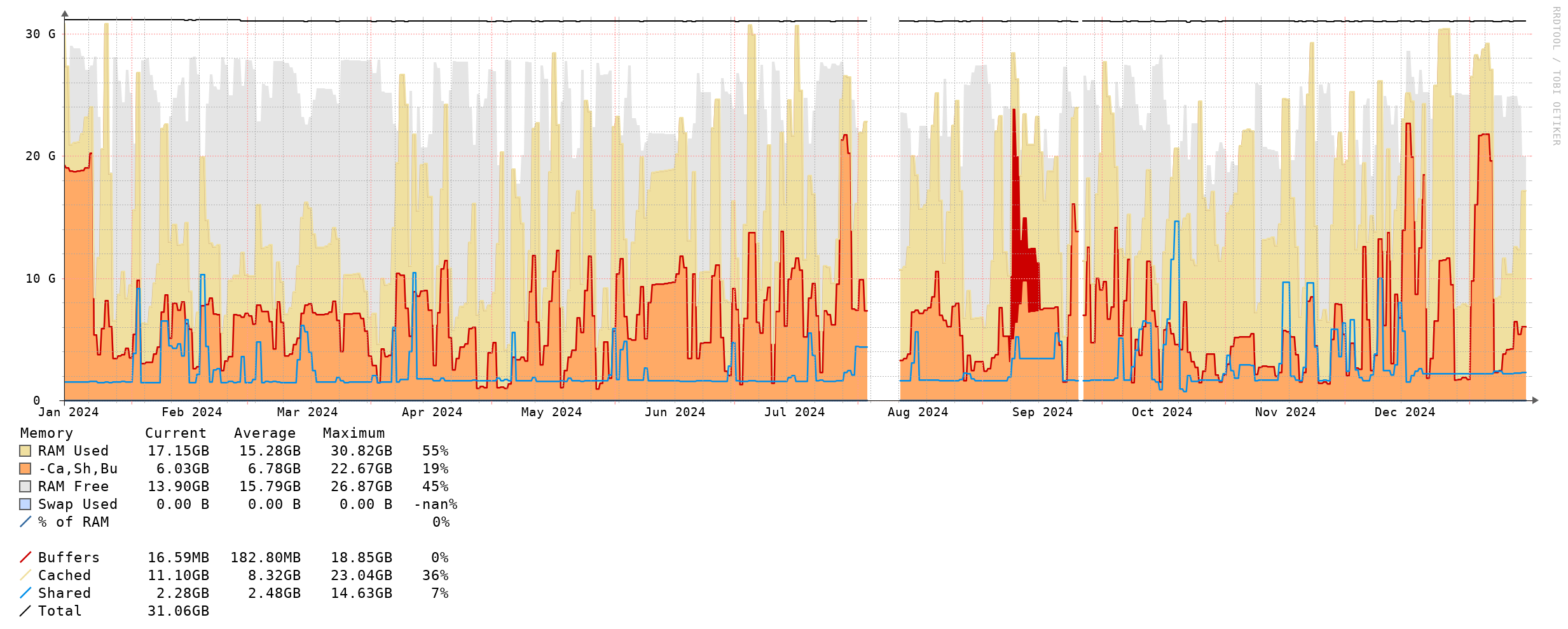

There must be something else causing your issue, I have been running 6.13/7 on my dev/test server for a long time SNMP has been running fine, this is the last 12 Months. This is observium which collects via SNMP.
