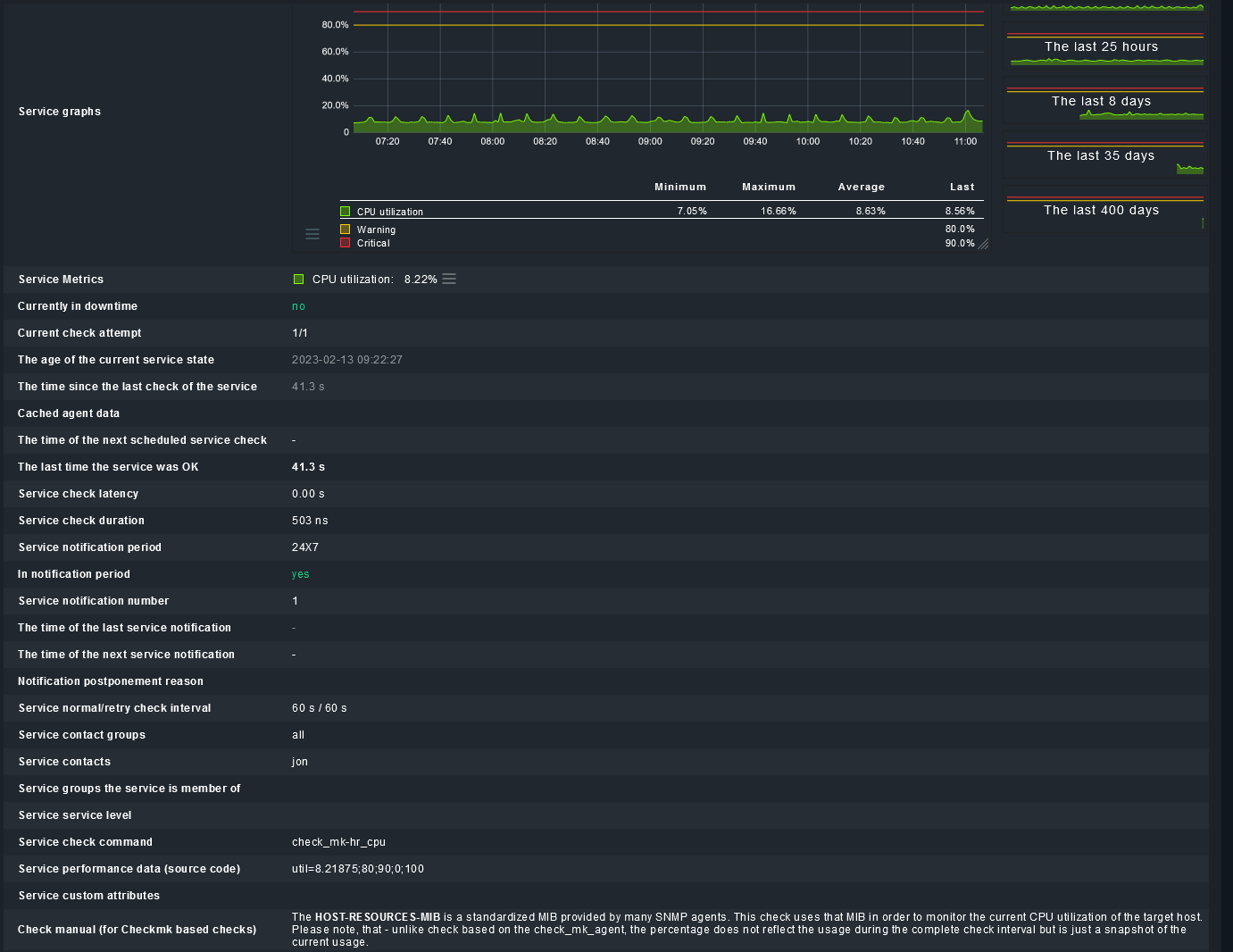

hi @kubed_zero and @irishjd this is the Result:
As Mainboard i use an MSI X470 GAMING PRO MAX (MS-7B79) , Version 4.0 with the latest BIOS
I have the same Result, that it's CPU min/max MHz
Is it also maybe some how possible to get the currenct CPU Clock like on the Unraid Dashboard?

Thanks all for the info. I just released an update 2023.02.18 that should fix this, now reading from /proc/cpuinfo instead of lscpu. I found during testing Unraid 6.12 that my VMs with an updated version of lscpu (2.38 vs 2.36) were no longer outputting CPU MHz at all, much less min and max.
Granted, my implementation only reads the speed of CPU core 0, but I figure that's better than nothing. Technically someone could submit a PR that grabs the CPU MHz from all the different cores and averages them out, or gets the max (or min) from all of them.
Let me know how install/update and testing goes @mattie112@MVLP @irishjd
Updated the plugin with no issues. I've attached a couple of screen shots from checkmk that reference CPU info.
Update was smooth ;)
