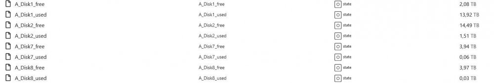

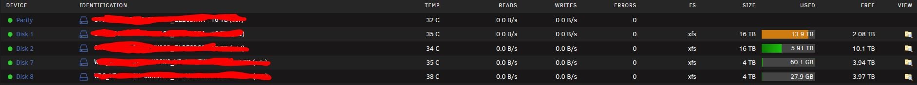

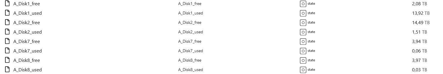

Hey Guys, maybe someone could help me.
I've got an  Problem when reading out the values for Free Disk Space / Used Space. Using the SNMP Plugin and in ioBroker also the SNMP Plugin to show me the values of my unraid machine in VIS.
I'm using this OID: .1.3.6.1.4.1.2021.9.1.13.1 to look up the disk free space for Disk 1 (also Disk7 and 8). Everything just fine. But if I try to get the values for disk 2, I'm getting some Values, but not the ones I see on my Dashboard in unraid ...
unraid:
ioBroker:
Whats wrong here ?
