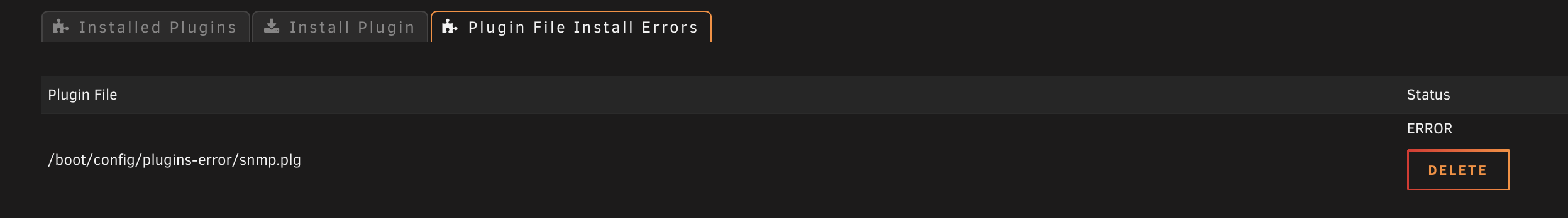

anyone using this on 6.6.0 its not installed after upgrading, and just shows in the tab titled plugin file installed errors
Seems OK now, looking in the log, it was moaning about not getting the little graphic so i think it stopped the whole install - i deleted it, reinstalled, and it seems to be working...
