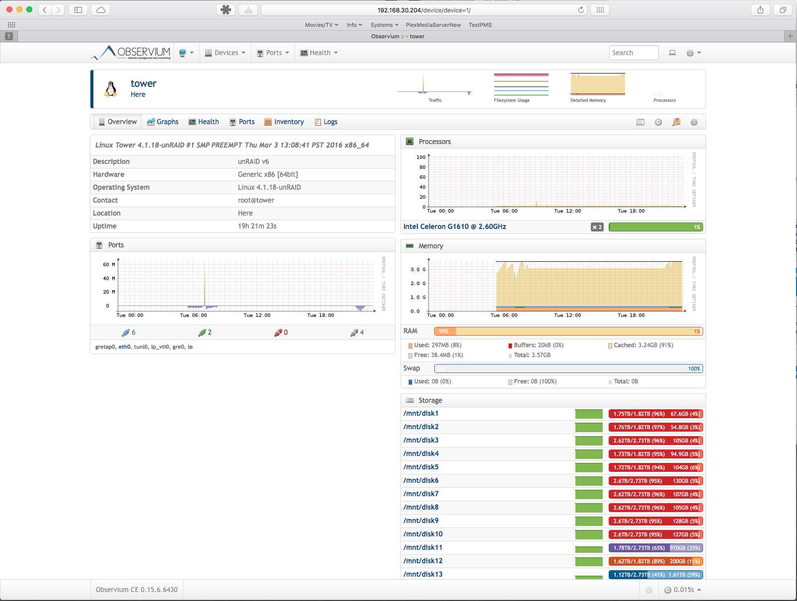

I just installed it on 6.1.6 no problem. Worked out of box with Observium and SNMPv2.

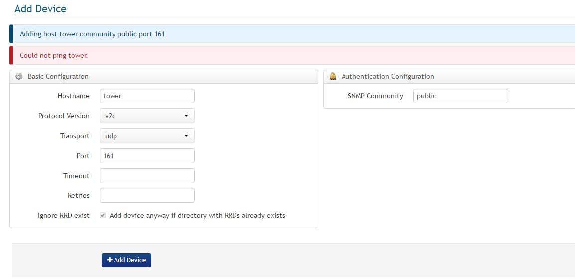

I have observium running and its gathering information from my pfSense box, ive changed the community string for the pfsense box for security reasons.  I modified the snmpd.conf on my unraid but it give it me an odd error.
"No reply using "XXX" using 2vc (XXX is an example of community string)
"could not read tower using the given the snmp parameters using v2c
--EDIT
set it back to defaults and i was able to get to discover, i dont like the fact that it uses public but it works,

You need a DNS somewhere in your network to resolve "tower" to corresponding IP address.
There is usually a simple DNS in a router provided by ISP.
From my experience with Docker it is not enough to use /etc/hosts on a machine hosting dockers (unraid in your case). There are some tricks to pass that /etc/hosts to docker, but easiest way is to use your own DNS either running on a router or on some server.
My ISP (Sky Ireland) provide a shite router (SkyHub 2.0) which does not easily provide DNS settings.
My Solution:
root@tower:# docker exec -it Observium /bin/bash
root@300cb02a1ebf:#vi /etc/hosts
add ip address and hostname to hostfile and BINGO, Observium resolves host!!

Based on that screenshot you will need to, the DNS setting pictured is not the same settings as previously mentioned in this thread.
Those two DNS servers are on the WAN (Internet) side of your router and won't resolve the names of your LAN hosts.
