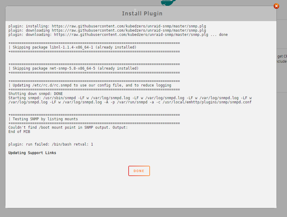

Trying to install this and I get and when installing I'm getting this:

The log says /boot can't be found. It's failing on https://github.com/kubedzero/unraid-snmp/blob/main/snmp.plg#L229
When I try to run the command "snmpwalk -v 1 localhost -c public hrFSMountPoint" on my host I get
root@myUnraid:~# snmpwalk -v 1 localhost -c public hrFSMountPoint
HOST-RESOURCES-MIB::hrFSMountPoint.1 = STRING: "/mnt/disk1"
HOST-RESOURCES-MIB::hrFSMountPoint.2 = STRING: "/mnt/disk2"
HOST-RESOURCES-MIB::hrFSMountPoint.3 = STRING: "/mnt/disk3"
HOST-RESOURCES-MIB::hrFSMountPoint.24 = STRING: "/dev/shm"
HOST-RESOURCES-MIB::hrFSMountPoint.25 = STRING: "/var/log"
HOST-RESOURCES-MIB::hrFSMountPoint.26 = STRING: "/boot"
It's also possible to run this replacing "localhost" with your host's IP address, like "192.168.0.2" or something.
If you can try to run the SNMP command manually and show us what you see, that could be helpful. Perhaps it's just not running and you need to reboot/reinstall. Or perhaps /boot truly is missing, but I can't see how that would be possible.
Edited by kubed_zero

Hello I have installed the plugin but where can I find the settings. I don't find anything under Settings.
There were also no errors during the installation. However, if I look again after the installation and apps, I can reinstall it, normally there should be a gear there. However, I do not have this.
If I look under Installed Apps it doesn't show up there either, but I look and there are plugins inside.
Regards Maggi
Edited by Maggi0r
Regards Maggi
There are no settings to adjust in the GUI, you could check on the PLG file to see how it's configured and how the config file is generated and then make edits yourself.
What do you want to find the settings for?
