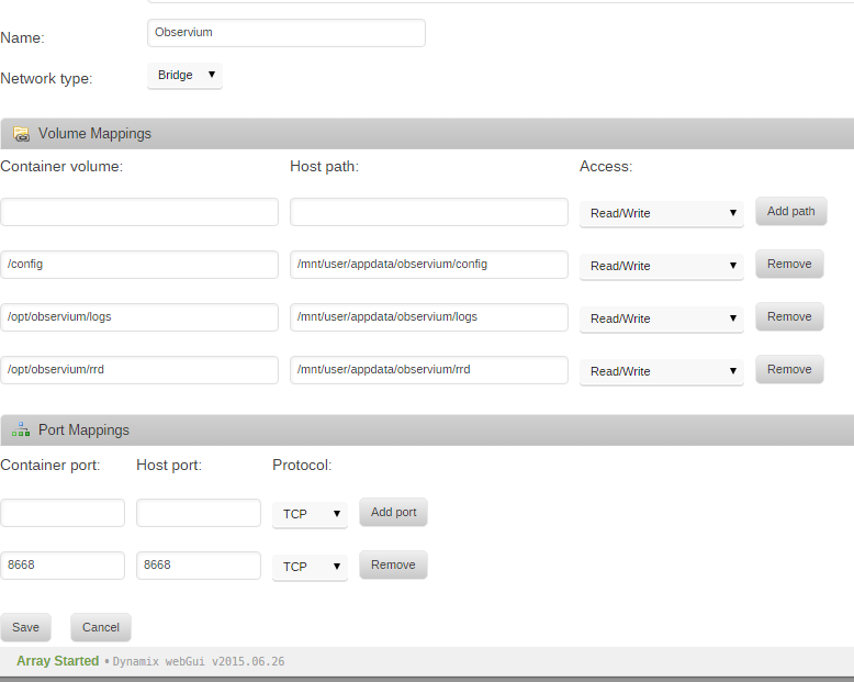

Hi Guys,
Not sure if any of you will be able to help me, i can't get my head around observium, do i install it as bridge or host?
if i go bridge i can access observium but can't add any devices, and if i go host it has a cry about sql, i believe because i am already running mysql on port 3306
Ideas?

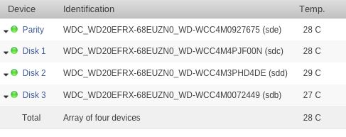

unRAID can see the temps - as shown in the screen shot below.  To complicate things - My unRAID system is a virtual guest on VMware ESXi.  The disk controller is "passed through" to the VM, and is dedicated to the VM, as are all the attached disks.
Thanks,
John
Can you log into your server and run the following?
/usr/local/emhttp/plugins/snmp/drive_temps.sh
Hi, I just did and it lists all my hard drives with a colon but no temperatures at all. Drives are all spun down though. Hope this helps, Alex. PS: I'm on the latest version of the plugin.
That worked:
root@OshTank:~# /usr/local/emhttp/plugins/snmp/drive_temps.sh
WDC_WD20EFRX-68EUZN0_WD-WCC4M0927675: 28
WDC_WD20EFRX-68EUZN0_WD-WCC4M4PJF00N: 28
WDC_WD20EFRX-68EUZN0_WD-WCC4M3PHD4DE: 29
WDC_WD20EFRX-68EUZN0_WD-WCC4M0072449: 27
root@OshTank:~#
Yeah, I can't always get temps if the disks are spun down.
That worked:
Well, is the config file updated properly?
$ tail -n 1 /usr/local/emhttp/plugins/snmp/snmpd.conf
extend disktemp /usr/local/emhttp/plugins/snmp/drive_temps.sh
What happens if you run it manually?
snmpwalk -v 2c localhost -c public 'NET-SNMP-EXTEND-MIB::nsExtendOutLine."disktemp"'
If that works, you can try restarting snmpd:
bash /etc/rc.d/rc.snmpd stop
bash /etc/rc.d/rc.snmpd start
