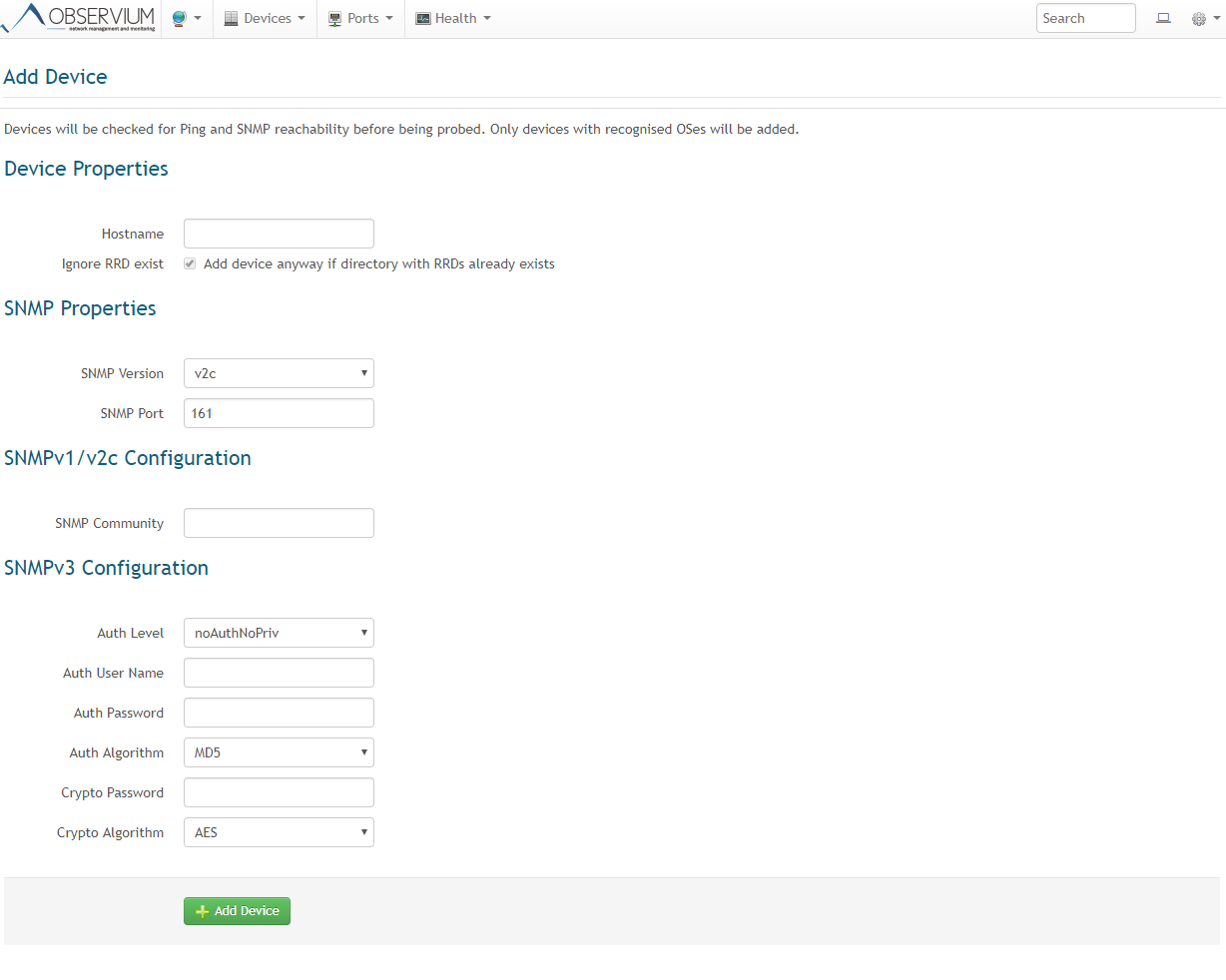

I've got this done so much. I'm stuck. what i need do to add my device?

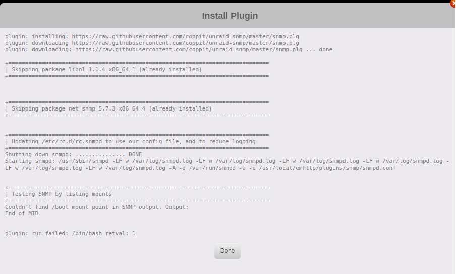

I've tried to install this plugin, but each time I get the following error.
Couldn't find /boot mount point in SNMP out.  Output:
End of MIB
plugin: run failed: /bin/bash retval: 1
Anyone familiar with this error or how to fix it?  I've scoured the internet, I have perl installed.
2 hours ago, Squid said:
Shot in the dark, but can you access your flash drive?
yessir.
