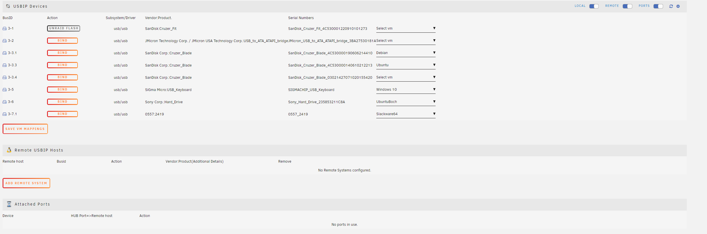

I will add this to the feature request also. I have started writing a plugin for usbip support, and was looking for ways to identify if usb devices are allocated to other services to restrict people from adding to usbip. I have already disabled the boot flash drive. But there doesn't seem to be an easy way to see USB devices allocated or in use at a host level for VMs, but came across this thread whilst looking for solutions.
Within the plugin I have all the details about the USB devices including serial number if the device uses it as some do not like the keyboard and BMC(kb and mouse) on my system. So I have started to see if I can add VMs.
Currently working on the processing of udev rules to support updates to my list if someone plugs in devices, but this could also be enhanced to include attaching to the VM if it is running. I will use dlandons libvirt-hot-plug plugin to assist with this so you will need to have it installed also. And likewise remove from VM if unplugged.
If I can find a way to be informed of a VM being started I may also be able to allocate devices after it has started.
My plugin is still in beta but I have added VMs to the screen so far but it is way off being ready for use.

The plugin now connects devices to a VM when it starts if specified in the settings, but you need to manually add a few lines to the qemu hooks file details on support page, working on how to do safely for install.
Plugging in a USB device if defined will connect to the VM if it is running.

Check out my plugin USB Manager.
