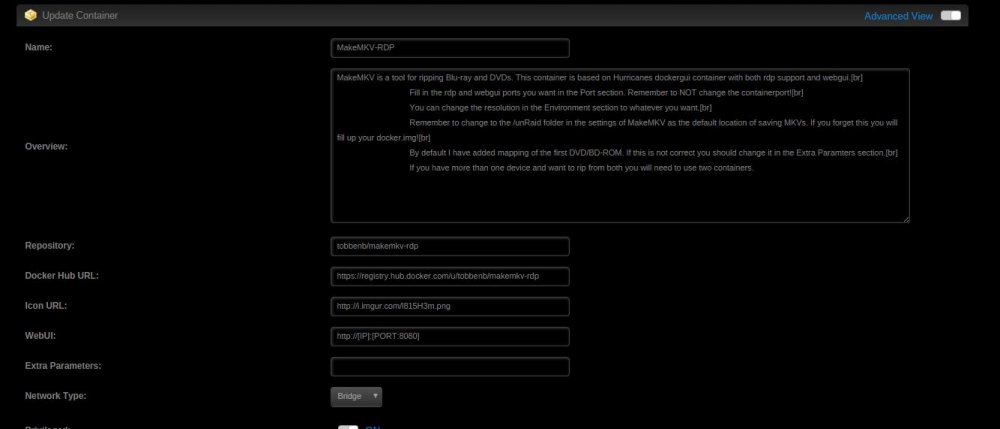

I had the same issue as I don't have an optical drive. If this is also your problem remove the /dev/sr0 line from the advanced options. Hope that helps!
How do i access that file it does not create the file or folder so how do i got about editing it? I'm a bit new to this thank you.
Hit "Advanced View" at the top right, and remove the "extra parameters" line referencing the optical drive like the attached picture. I believe I made the same mistake and it's in this forum post a few pages back. I think that most people use this for use with an optical drive so the author included those parameters. I just use them for ISO and BDMV index files, so my container also failed in this same way as I don't have an optical drive.
Edited by mikedpitt420
That worked thank you're a life saver.

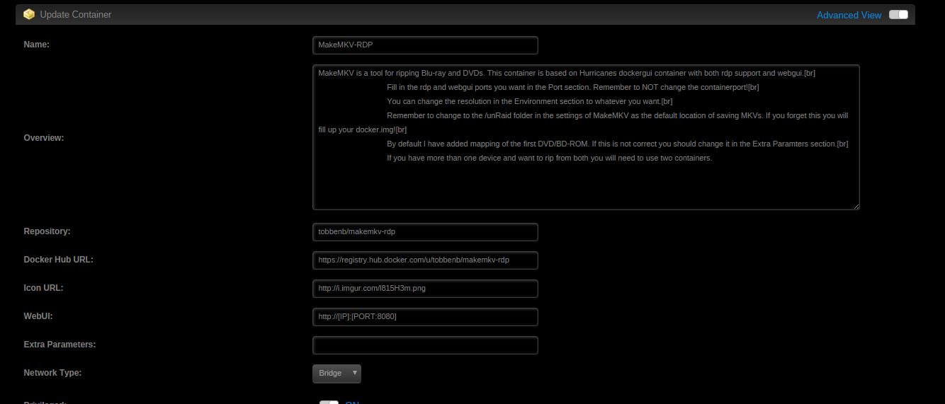

Can you post a screenshot of the template for the container and click the Show advanced settings line?
Your setting files shows that it was created by makemkv 1.10.5, but a fresh install should say 1.10.7.
Have you tried changing some settings the first time the container starts, and then go see if the file exists?
There's the settings for the template. I'm sorry I don't quite understand what you mean by changing some settings. What should I change?
