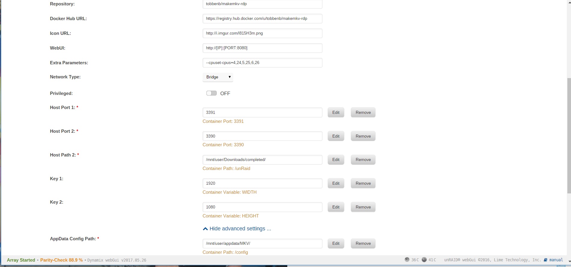

How can i go about getting the USB 3.0 BD-Drive detected mine shows as no drive available. I plugged it and i can hear it spinning the movie but i can't seem to find a way for unraid or MAKeMkv to detect it. Is there a option  i have to run on or something? Thanks.

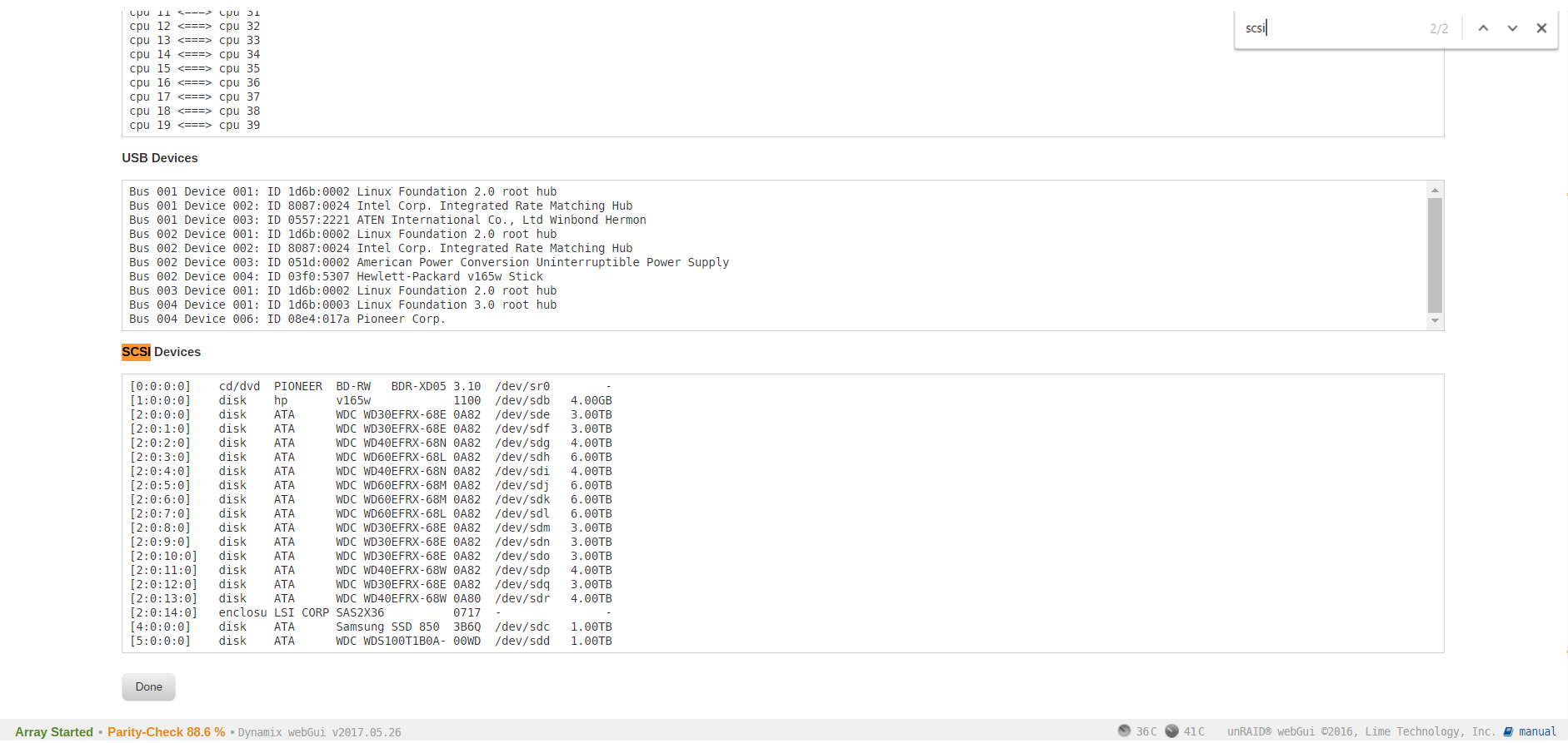

Do you see the drive if you go to Tool --> System devices and under SCSI devices? It should be /dev/sr0.
Can you post a screen shot of that section and also of your makemkv template with the advanced mode turned on?

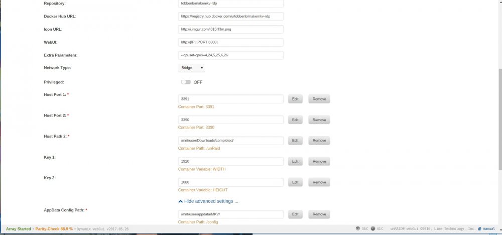

I just posted some images.
You have removed the optical drive pass through tag that was in the extra parameters box. You removed it when you added the cpuset stuff.
Add --device=/dev/sr0 before or after cpuset.
So how should the command line look like? --cpuset-cpus=4,24,5,25,6,26--device=/dev/sr0 i did that but got command failed.
