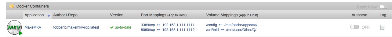

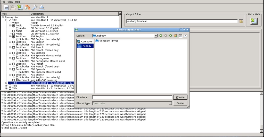

What did I set up wrong? I set my export/save location in the Docker settings to a folder on my array but when I choose the location within MakeMKV it's showing something completely different. Also, it said there were only 5070mb available but my array should have 5+TB free.
Sorry for my noob questions - this is my first Docker install & setup :)
Here's the Docker screen:

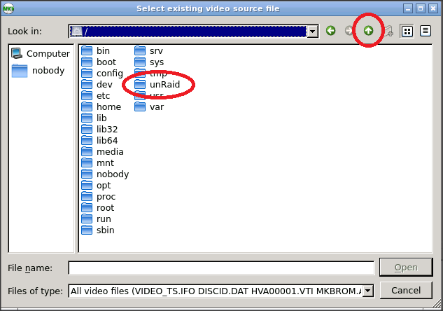

You are almost there….! The folder you are looking for is unRaid. That folder is mapped to your folder Q located in the share called Other. So just browse for the unRaid folder in the MakeMKV file dialogue.
That was it! I didn't think I had access to that folder but it turns out the UP arrow took me straight there. Thanks for your help! I'm ripping a test BD right now :)

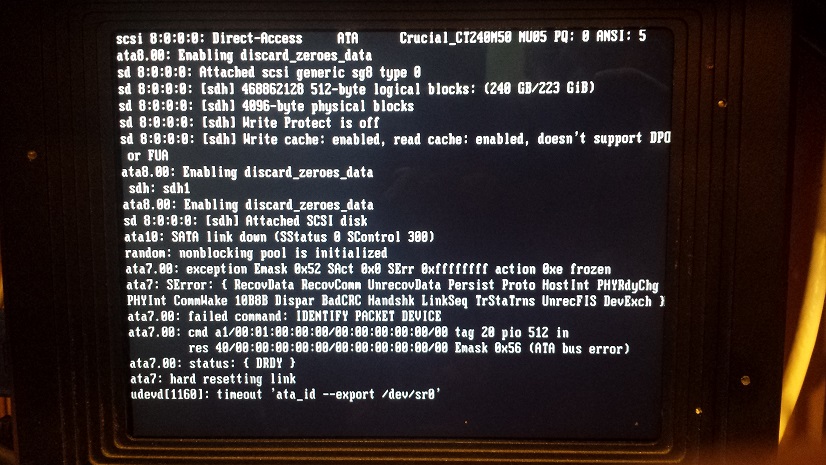

Looks like I have to do some digging - for some reason the server hangs if a DVD is attached to the SATA port.
I noticed the MakeMKV site has been down for around 5 days - is this a concern as far as updating the key? Do we even need to? (I noticed the Docker version tells you the eval is up but doesn't stop you).
Is it connected to onboard controller or controller card?
Maybe a bad cable?
Probably he just forgot to re-register the domain. :)
onboard, did try different cables even different DVD units, will try a Blu-ray unit tonight and maybe a controller board.
That is weird. Might have been something that was needed for DVD drives that got removed in the latest release?
I'll add a pre-6.1.3 version to my list for tonight :)
Seems like the issue resides on my hardware and not unRiad version.
Need more investigating into maybe the powers supply I'm using for my server.
The DVD on SATA port works OK with 6.0.1 on a different server but when the same 6.0.1 USB stick is being used on my main server it still locks at the same screen.
