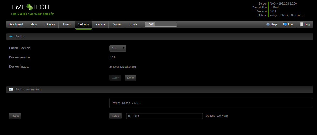

August 12, 201511 yr Community Expert Go to Settings - Docker and copy the text that appears in the box under Docker volume info and post it.
August 12, 201511 yr Author btrfs-progs v4.0.1 scrub gives ERROR: getting dev info for scrub failed: Inappropriate ioctl for device
August 22, 201510 yr Author So I'm am finishing up setup but I completly cleared my unraid box and started over from scratch. Now it shows the following under Docker Label: none uuid: 8fd80e0f-fde6-4b81-8bbd-4acbabe2df41 Total devices 1 FS bytes used 627.23MiB devid 1 size 20.00GiB used 3.04GiB path /dev/loop0 btrfs-progs v4.0.1 I think that has fixed things. I will post again after a week or so of uptime.
