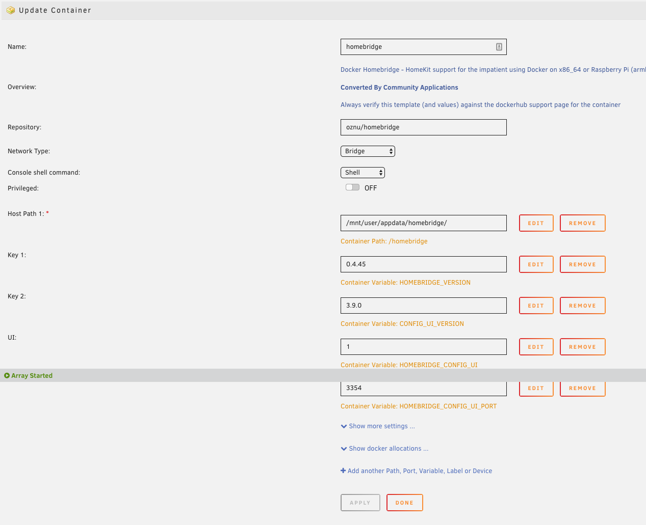

Trying to get this to work. I followed the instructions.
in console i get the I’d code. But i cannot get to the UI set to 3354.
Any advice?
thanks
h.
Edited by hernandito
Any advice?
thanks
h.
I happen to be using Network Type as Host instead of Bridge.
You can either change it to Host or you'll have to pass the appropriate ports to the docker container (Homebridge service, GUI, possibly other stuff...)
I believe that should do it.

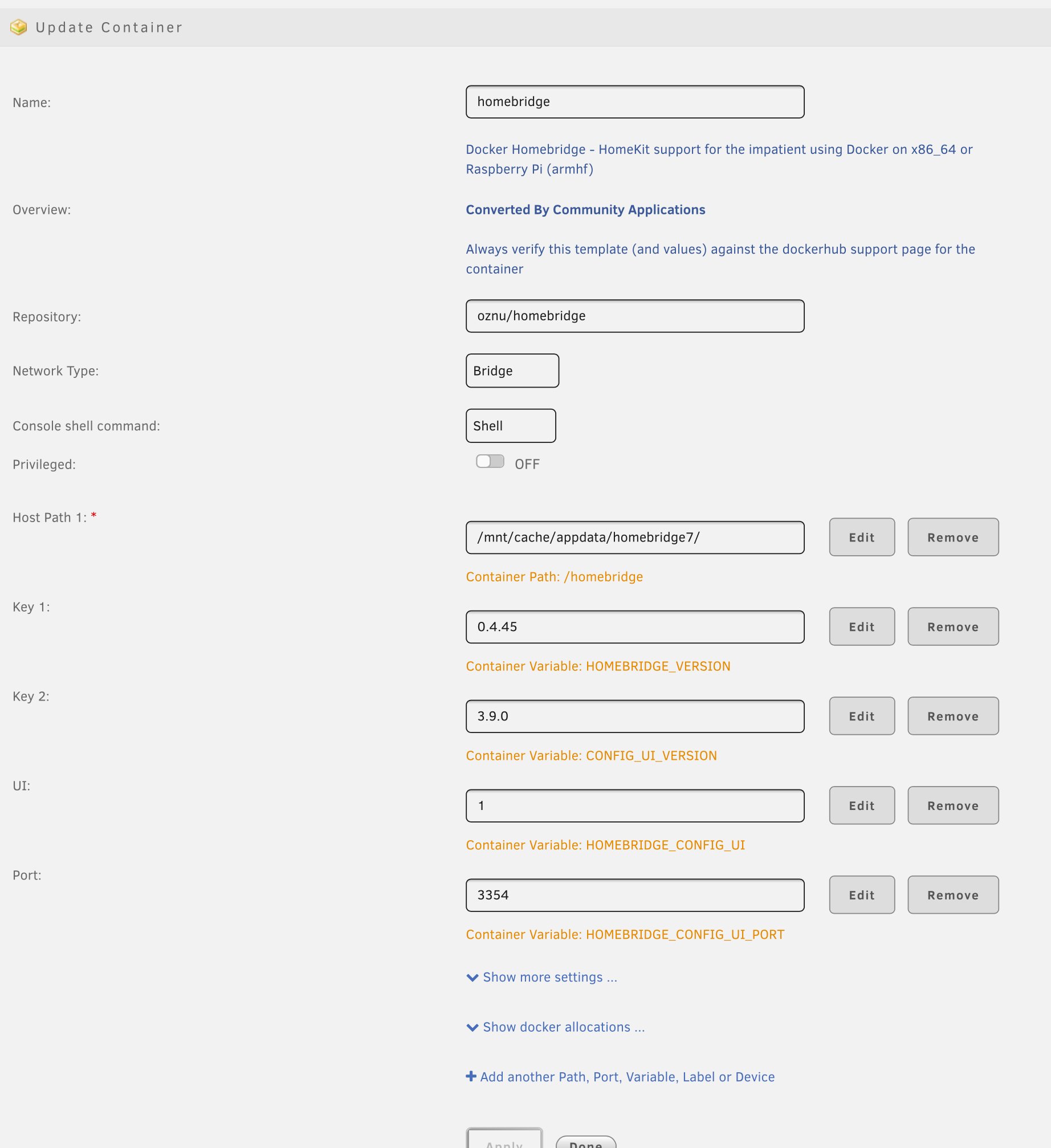

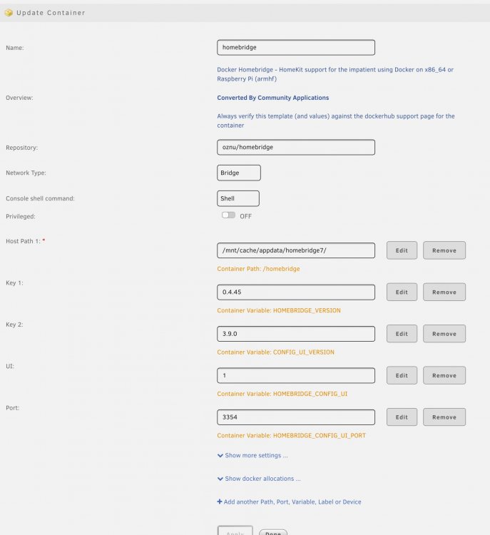

I just tried following the directions and I cant get the Web UI option in unraid.  My config is attached - can anyone spot anything wrong?  I have tried setting network to both Bridge and Host and neither option seemed to work.  If I go to http://serverip/3354 it doesnt load anything.
Edited by bdee1
OK I think I figured it out.
Config UI X installs as a Homebridge plugin. It defaults to port 8080.
You should update config.json manually for the port of the UI and then it should work.
hmm - that makes sense, but I change the port to 8080 in the docker config in unraid and tried again and I still was unable to load the Web UI.
Bummer nothing works.
changed Json file to port 3354, and tried both bridge and host mode and no luck.
Thanks.
That stinks. Working over here fine. Might try removing the docker and image and then reinstalling with all the setting as is.

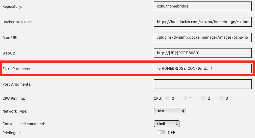

If the docker is running, but the gui is not accessible, give this a try.
Edit the container, change to Advance View and in the Extra Parameters, enter this:
-e HOMEBRIDGE_CONFIG_UI=1
I don't think you actually need the variables HOMEBRIDGE_VERSION, CONFIG_UI_VERSION, HOMEBRIDGE_CONFIG_UI, HOMEBRIDGE_CONFIG_UI_PORT if you do the above.  They don't seem to do anything after the initial installation.
