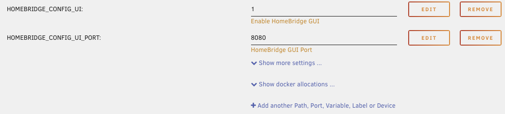

4) Add the two docker variables needed to enable the GUI by clicking on "Add another Path, Port, Variable, Label or Device"
HOMEBRIDGE_CONFIG_UI, set to 1 to enable the GUI
HOMEBRIDGE_CONFIG_UI_PORT, set to 8124 (8124 seems to be the default in the config.json configuration file when I installed)
If you change to a different port, eg 8080 (as above) then you have to update the corresponding port line in the docker's /root/.homebridge/config.json file from 8124 to 8080 (see below).

Enable UI:
Add these variables
HOMEBRIDGE_CONFIG_UI_PORT, set to 8080 or whatever port you want
Then you can access the UI at the configured port above.

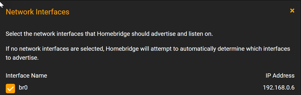

Hi All
I am using the OZNU Homebridge docker.
And it works for everything except the Sonos ZP plugin?
I have by troubleshooting with the auther found that it is upnp that causes these problems?
What network setting are you running with?
Mine is:
And in the UI:
But I keep getting periodic UPnP announcements for .6 - the HOST! ?
[4/19/2022, 9:00:21 AM] [Sonos] upnp: RINCON_542A1BE254D901400 is alive at 192.168.0.6
Any input on how to resolve this?
