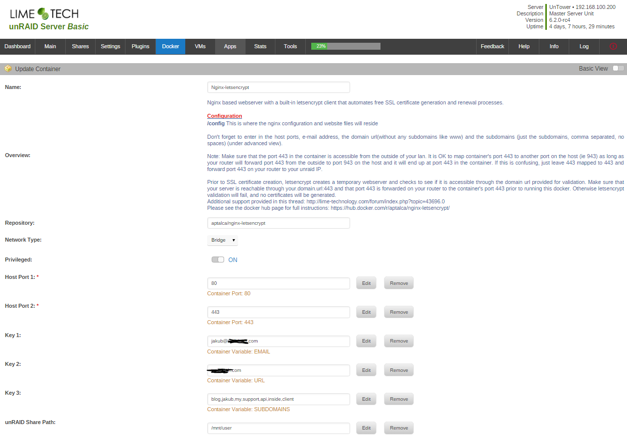

Im having a problem with subdomains using this container. SSL working just fine, but when I try to work with subdomains what happens is all subdomains behaves like the domain itself... it ignores config files and no maptter what subdomain i enter, it all goes to default server config and its locations...
Config files for my subdomains which I use are the same I used for my previous NGINX container where it was working correctly.
Can you please advise what should I do to make it work?

Several issues with your config files. Each server block has to have its own cert, cipher, port, etc. settings. Your subdomains don't have those and they are only set up to use port 80
You are also mixing subdomains with url prefix redirection. The way it is set up, http://inside.xxxxxxxx.com/jenkins will be forwarded to http://192.168.100.210:8080/jenkins/ and only on port 80, not using the certs or https.
I think you should follow some guides for setting this up correctly
